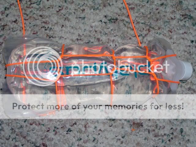

I'm sure there is a more elegant solution (post it if you know what it is :)), but several half hitches later looks like it will do in a pinch
this is a platy bottle, but the above linked container is very similarly shaped/sized

I'd probably opt for my "half hitch a plenty" rigging before giving up a sleeve :)

my intended use is having the bags folded flat (in a aloksak), if needed removed cordage from my knife to form a carry option- I toted the bottle around slung over my shoulder and it seemed pretty secure, so the half hitch method appears it will work
