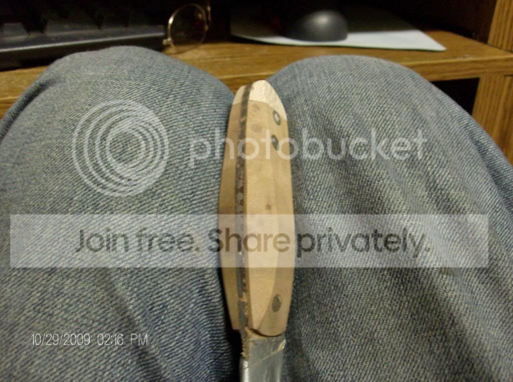

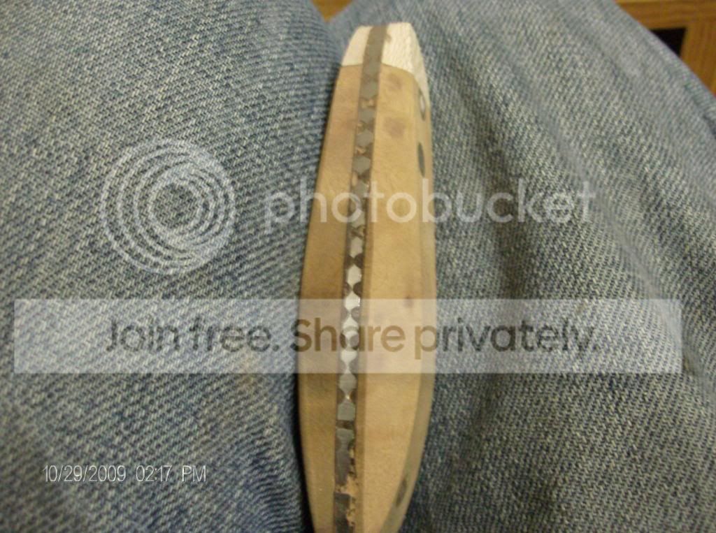

I glued on my scales set my mosaic pins and mosaic lanyard started to sand with like 60 grit on slack belt mode and over sanded. So I then cut off the bad area and reattach some sycamore to the camphor burl 2 days later I was ready . I first started to hand sand with 150 grit and thought A WHAT THE H ___ L and in 3 second sanded down to my file work and ruined 4 hours work . I never worked with camphor Burl before and it will be my last.

You haven't wrecked the knife.Just the handles.Time to bust them off and start a new set.I've done it a time or two.Will really chap your backside.

Mistakes can usually be fixed. I would just grind the spine down flush. You won't have the filework but, you'll have a clean looking knife. I don't think I've ever made a knife that I didn't have to modify because of a mistake.

I'd also just grind the handle to remove the file work. I filed a pattern into two knives when I first started out, and I haven't file-worked a knife since. I just love the clean look without it. Now there are makers who can pull it off, and I love the look on some of those blades. However, most of those makers are far more advanced than I am, and their work speaks for itself without the file-work.

Nick you may be right and I respect your comments as well as all others but how can one get better if they dont try. You are most likely right in certain respects of filling . First off I am working on CPM154 which is harder than any other steel that ive ever worked on . It is a superior steel that needs no baby sitting with a oil can and thus being so hard to start with makes learning that much harder. I have noticed the guys that make file work look like art ,are working on damascus other soft tool steels.I am very aware of trying to keep my grind lines straight and equal . I will be making a new tool rest shortly this will improve my lines and symetre. Nick I am basically self taught and I do appreciate all your advise its the only way I can correct my misstakes is told what im doing wrong. Just to let you all know the camphor burl has soft spots and was not stabilized very deep and i hit hollow or unstabilized spots. The wood is full of oil so probably cant be stabilized . I finished the knife and will just give it away cuzz I dont like it, the blade is sharp as a razor blade . I could redo it but Ill chalk it up to learning.
Ya I know Phil . Im not afraid to get comments for somthing stupid I did . Thats why I post when I screw up so no one else will do the same ,well at least this week lmao. I looked at the file work too and most of that is the picture is taken on an angle and distorted . Hey I know im not close to getting any knives in a magazine but if I keep trying I might make last page some day. I do know now some woods just cant be stabilized its all a learning process.

There is nothing wrong with champhor burl , nice figure . Hand sand , treat with teak oil and buff on a loose buff with white diamond compound .
