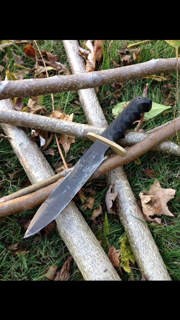

How tough are Randall knives?
Their tough
http://www.bladeforums.com/forums/s...n-to-others-I-ve-used?p=14739397#post14739397
http://www.bladeforums.com/forums/s...ess-field-test-review?p=15286067#post15286067
[/URL]
[/IMG]
When I get my beautiful fighter its not getting abused. It might live in a drawer to be admired sometimes.
The small dagger might even get carried, but if I wanted a knife simply to abuse id have kept some of my many busses.
Seriously drooling over this one. Love that guard.
