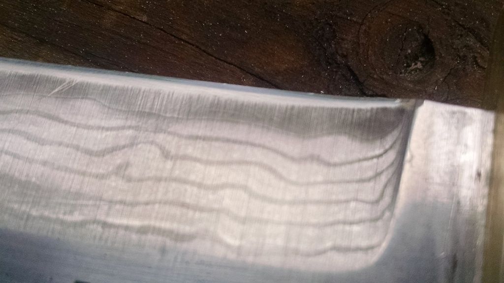

Other thoughts are the edge is VERY HARD, how hard exactly is anyones guess, I would say harder than 65 HRC (Guessing) and with the geometry tested it was very stable.
And it's a forged blade and laminated steel.....
Other than that all I can say is it did what it did on rope performance wise.
And yes I did test ending sharpness with my sharpness tester and it's in the range it should be by my growing database. (Not published)

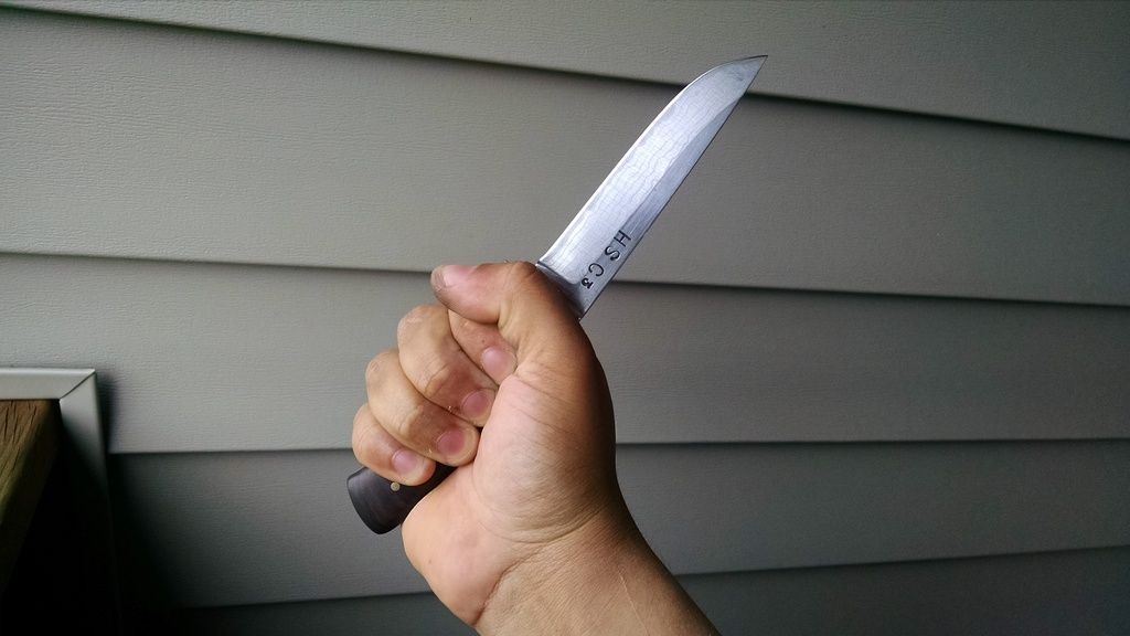

it's one of the very first laminated steel knives I forged, it's like a short paring or utility knife.
I just ground the bevel to expose the core and sharpened it.
Nothing scientific about it. It's about .05-.06 at the spine, flat ground, that's it.

I'm saying it's a 64 HRC but it's true I don't know the exact hardness point.
I'm trying to obtain some raw unlaminated white steel from Murray to do some hardness testing as a guide. I do have a hardness tester.
From my HT procedure -
The tempering is done almost immediately after pulling out of the quench. I use the aid of a Tempilstik marker. The tempering is very fast and there is no hold or soak at the temperature. The blade is brought up to temperature (checked with Tempilstik) and removed and allowed to air cool. The time to come up to temperature is only a few seconds, so you have to pay close attention.
I use a 350 deg F marker and now I also use a 400 deg F to make sure I don't go over,
This "auto-tempering in a short time is a Japanese method. It produces very hard edges. Hitachi steels produce such fine grain that this type edge works." (S. Apelt)

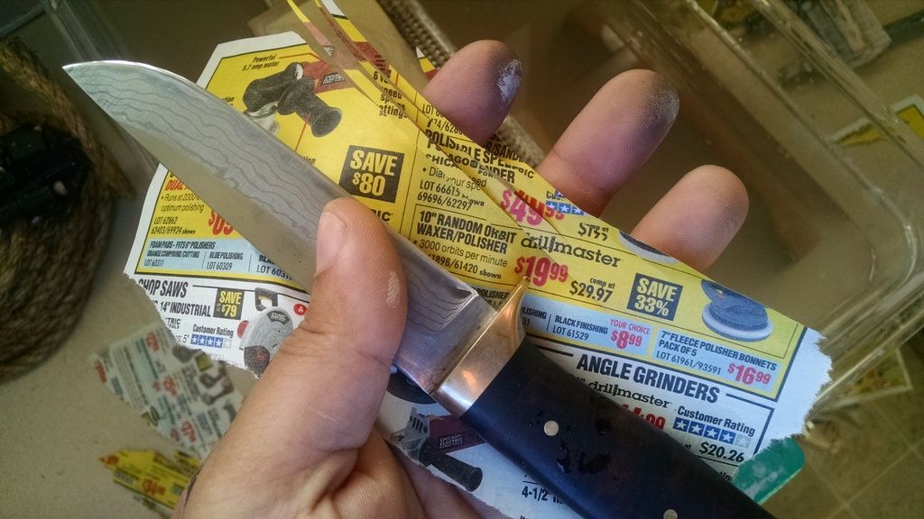

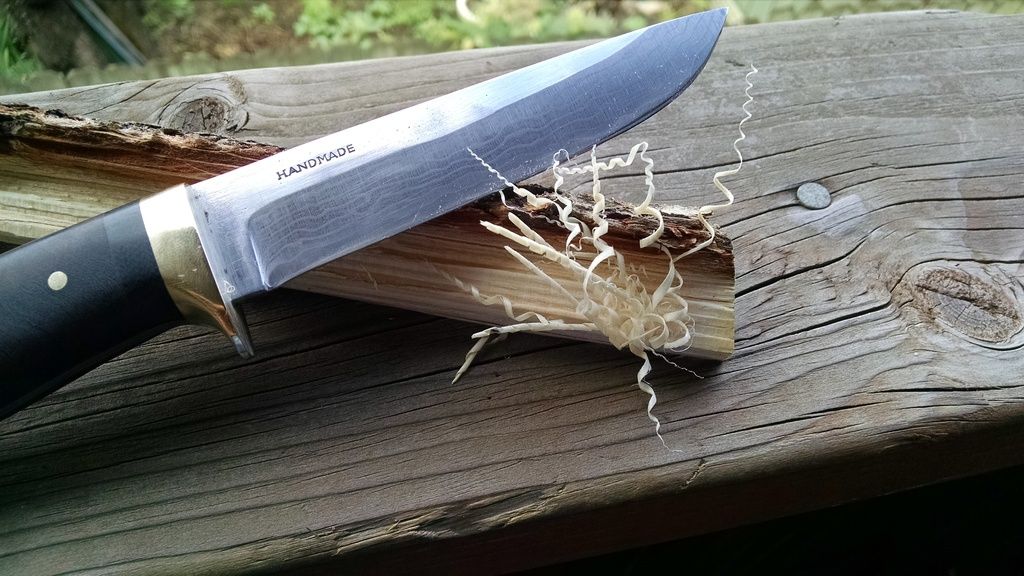

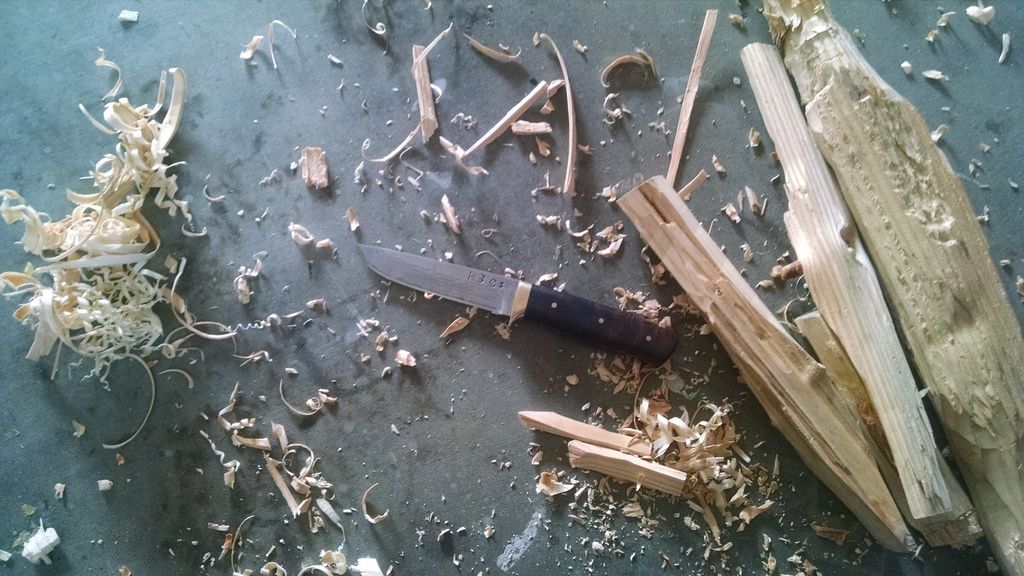

When I received the Knife from Harbeer, I sharpened it on a 1k King stone with some stroping on a 6k King stone @ ~15dps.
(This is before the video reviews)
It was cutting news print with silky smooth ease.
Very exciting.
I can't elaborate in words how incredibly easy it was to achieve such sharpness.

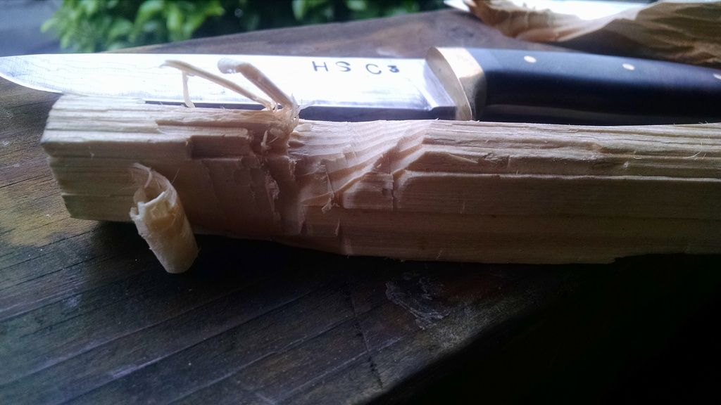

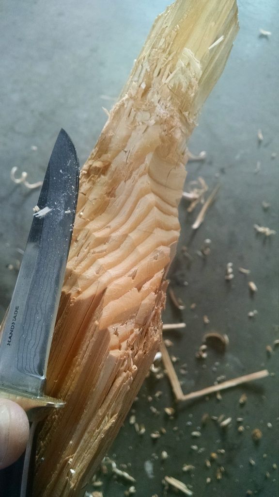

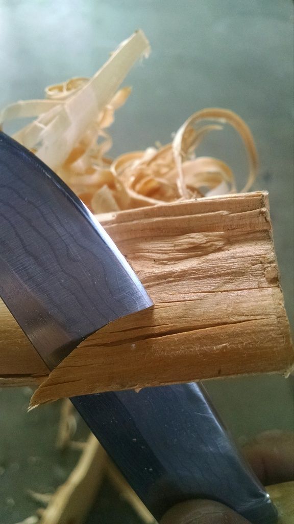

Time for some Bushcraft testing

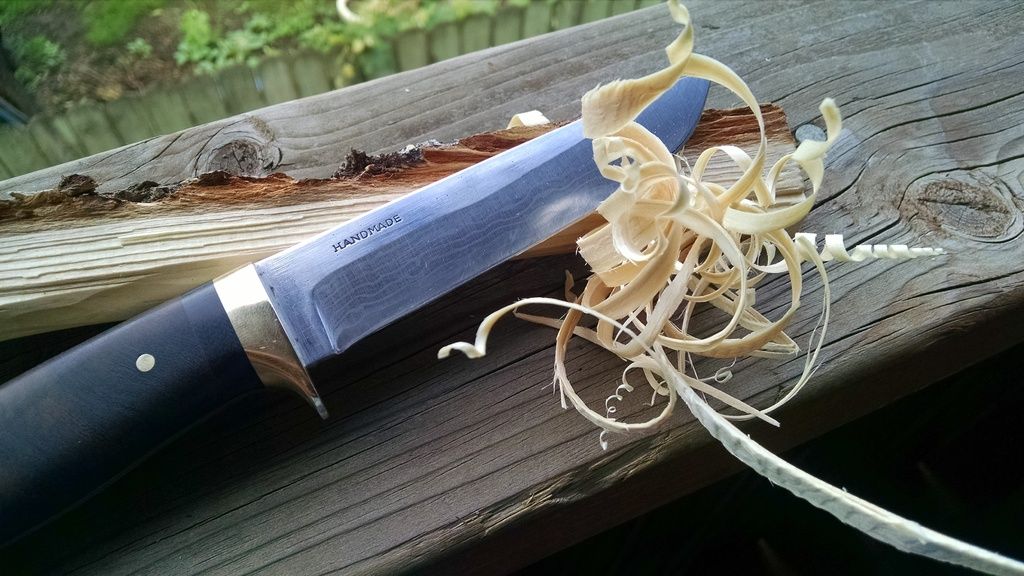

The bite in a piece of soft pine with a chest lever cut.
Great penetration.
Carvered very thin almost transparent feathers for tinder.

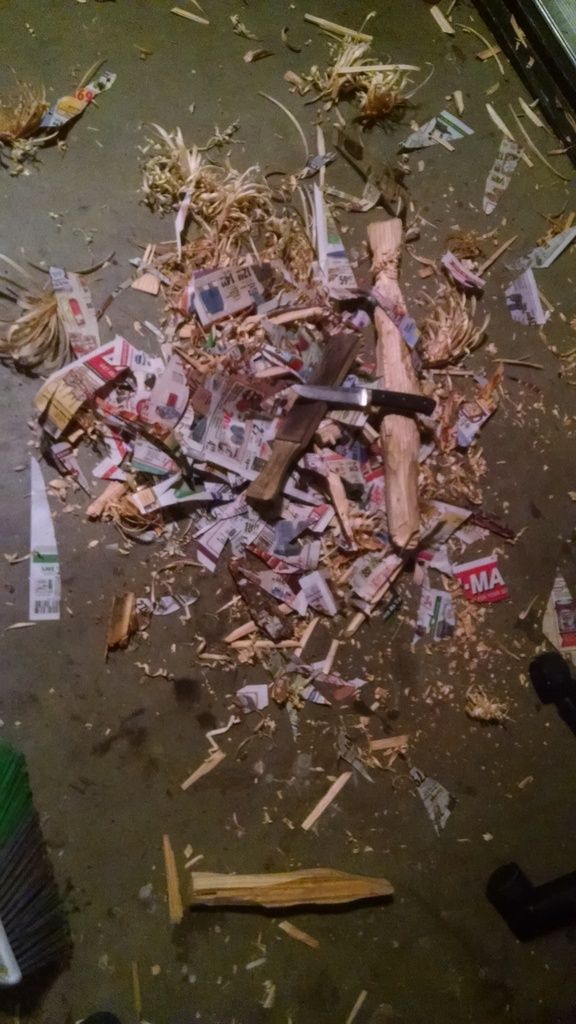

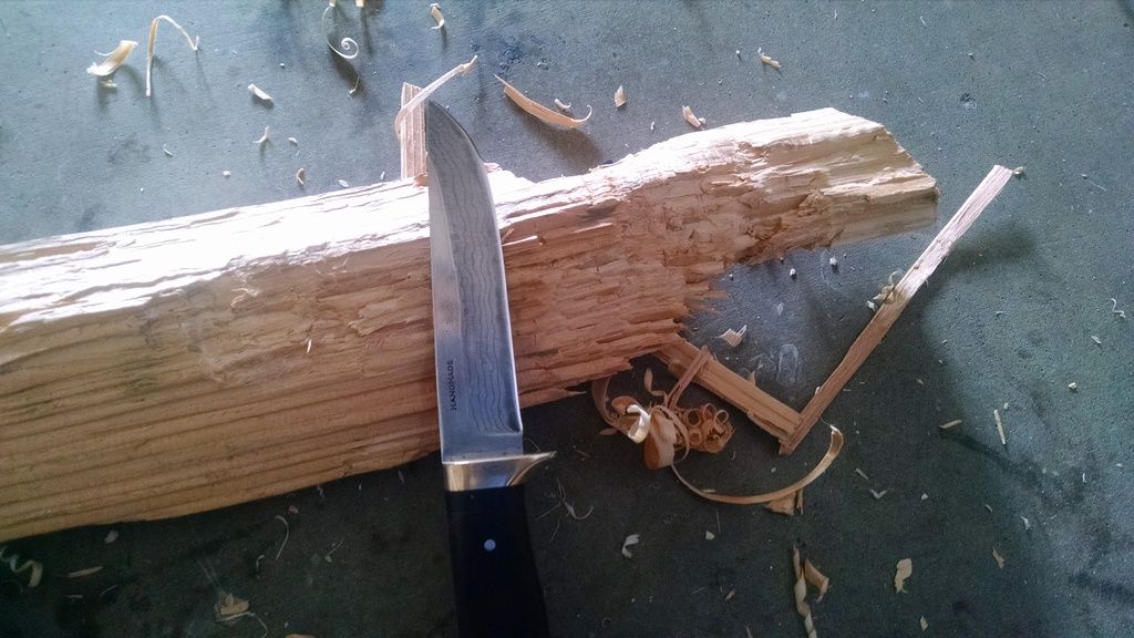

Time for some rough use cutting.
Using full strength chest lever cuts to clean up this piece of wood.
Here what I'm working with.
The Utility Hunter smoothed it out great and cut well.
Lots of various cutting. Feathersticks, notcthing, carving.

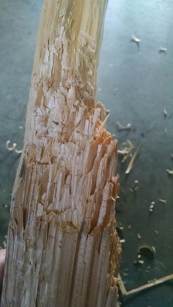

While the knife was still very sharp.
Some micro damage to the edge was observed.
15dps was too acute for this type cutting
There were some small deformations in the edge
The knife was still carving great though.

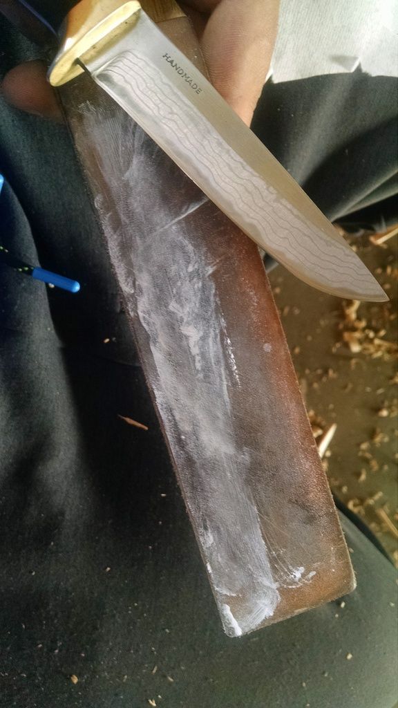

I stroped the edge with Flitz metal polish on leather.
Yet the damage was still there. This is not uncommon most knives need a hard stone to burnish the edge back in alignment.
I was able to remove the damage with my trusty ol' DC3-
-Using some stroping strokes with Both the worn diamond side and the brown ceramic.

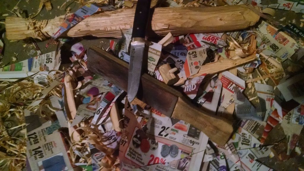

It was time to find a better edge geometry for carving.
I reprofiled the edge to ~20dps using the king stones again.
Then it was back to testing.
I spent hours carving wood and looking for damage and testing on news article paper.
There was no damage to the edge.
And the knife stroped back to razor sharpness.

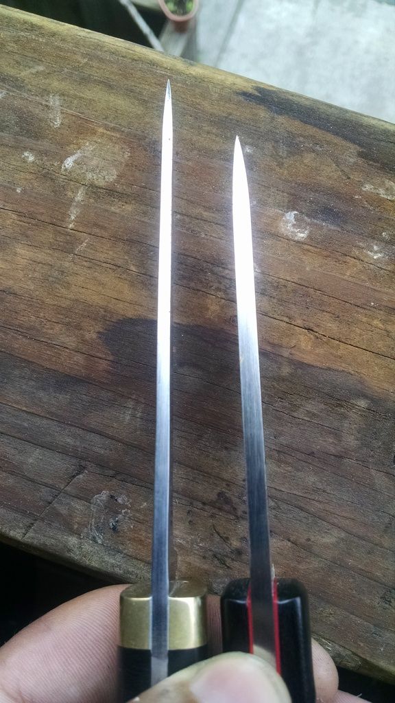

There was definitely a performance decrease with the steeper geometry but it's always a trade off.
The geometry is very thin. It's designed for hunting with some utility function as well.
In the hands of a capable hunter I can only imagine the performance since the edge geometry can be very acute.

For carving wood, thickness is required behind the edge to help split the wood for the primary edge to continue cutting.

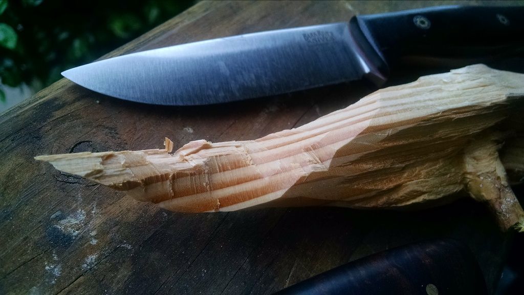

Here is quick comparison to a Bark River Gunny Elmax
Doing a spiral cut
This gives an example of the wedging and cutting effect we call "bite" in the wood.
The HSC utility hunter doent have as much bite and gets stuck due to the thinner geometry behind the edge.
While a very capable field knife it won't carve and blast through wood as efficiently as some thicker knives
Yet given a slicing task and this blade while outcut the thicker blades.

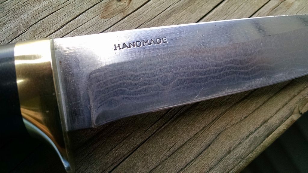

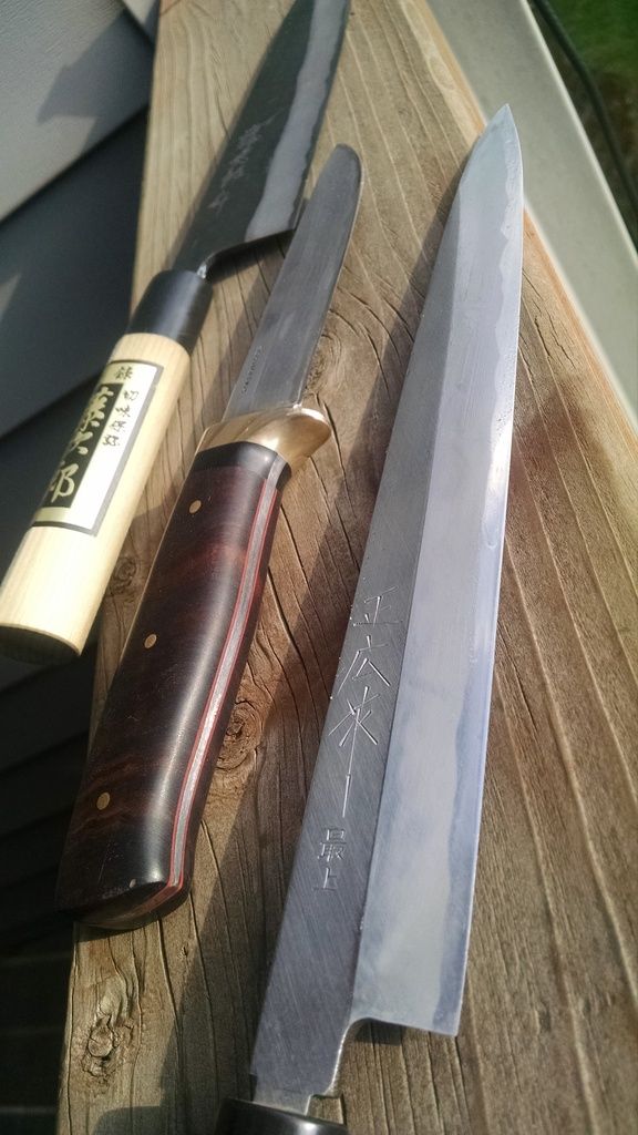

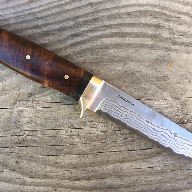

The most memorable aspect about Harbeer's work is how amazing this white steel takes an edge.
It's definitely on of my favorites as seen on my laminated white steel Gyuto and Yanagiba.
There is nothing like it.
So sharp!
Great work Harbeer.

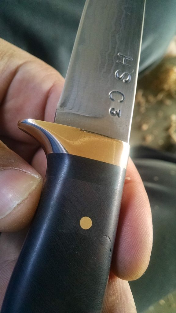

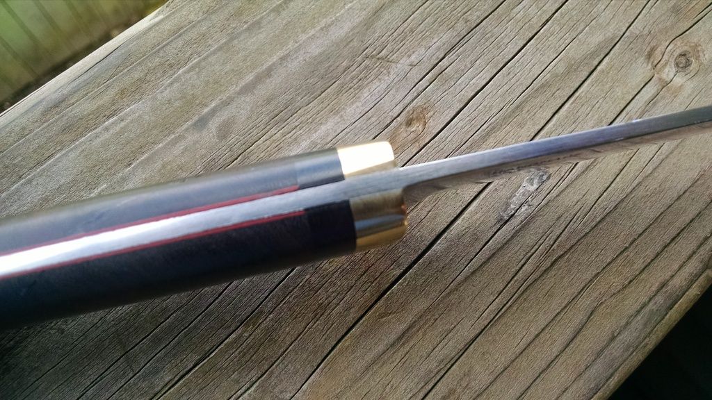

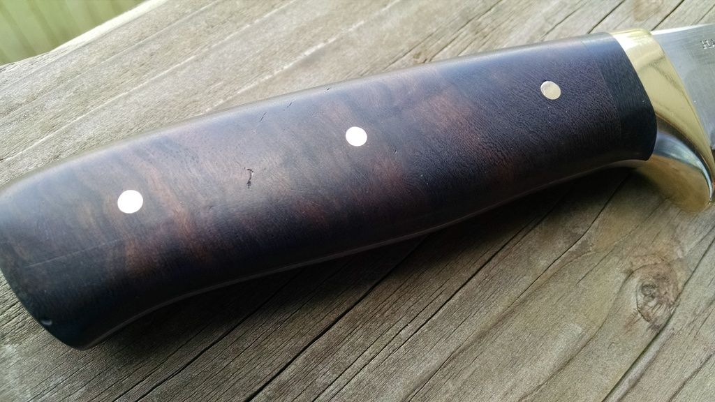

The Handle.
Throughout my testing with this blade I've grown very fond of the handle ergonomics.
It was very comfortable despite my large/xtra large hands.
There where no hotspot or tactical traction anywhere on the handles that would rip the skin off the hands from long periods of hard use.
The swell is very subtle but extremely comfortable with nicely contoured scales.
The guard was very well finished and was extremely comfortable even in different positions with hard use.
I'm also a sucker for aethitics. I love the red liners and the black Micarta.
Very stylish and we'll fit. Makes me drool hahaha
The guard is soldered with a low temperature solder. This takes alot of time and skill but is outstandingly durable and gives the knife a clean look.
The brass guard really "pops" with a nice polish.

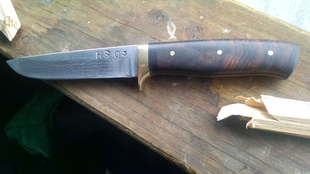

The sheath will be a kydex pancake sheath. I wasn't provided with the actual sheath this model comes with since I wanted to get this knife in my hands as soon as possible.
Harbeer is still working on the sheath design.
In conclusion, for $375 one gets a handforged high performance knife that is also very pleasing to the eyes and hands.
Whether an avid hunter, Outdoorsman or collector.
This should be an exciting knife in anyone's personal line up.

This knife so far performed very well. What kind of bone contact/impact/deflection this hunter knife edge supports? One can always dream of bagging an elk and quartering it :) And on the utility part - how does it fare whittling seasoned pin-knotted pine? Just wondering, so I would be glad to receive either guessing or actual tests.
Thanks Luong 😁
I wish I had the opportunity to test it on bone 😁
Also for wood carving, I didn't test it on knots or do any hardcore batoning.
It didn't seem like anything it would excel at so I didn't care to know.
So in Honestly, I can't tell.
I only had the knife for a week or so.
It's plenty tough for normal use.
