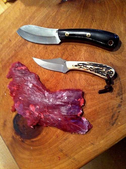

It would look a lot like this:
Although I do like Loveless-style drop points as well. Both have their place, and for big game, I usually carry both.
**Edit to answer a few more of your questions:
For skinning, I really like a trailing point. Why? Well, it's what trailing points were largely developed to do - provide a sharp, bellied edge while getting the tip out of the way, and thereby reducing the chance of an accidental puncture.
For actual butchering, I really like the BHK MUK pictured below for dealing with the bigger pieces. Why? The Muk is just a butchering machine. A nice deep profile, again combined with substantial belly, allows for a very 'slicey' blade. And while its on the big side of my usual preference for a game knife (9" overall), it still works really well for smaller cuts and detail as well. I find that it's also great for what I call a "rocking cut" in which the blade can be rocked back and forth over a surface like a cutting board as the meat is passed under it.
