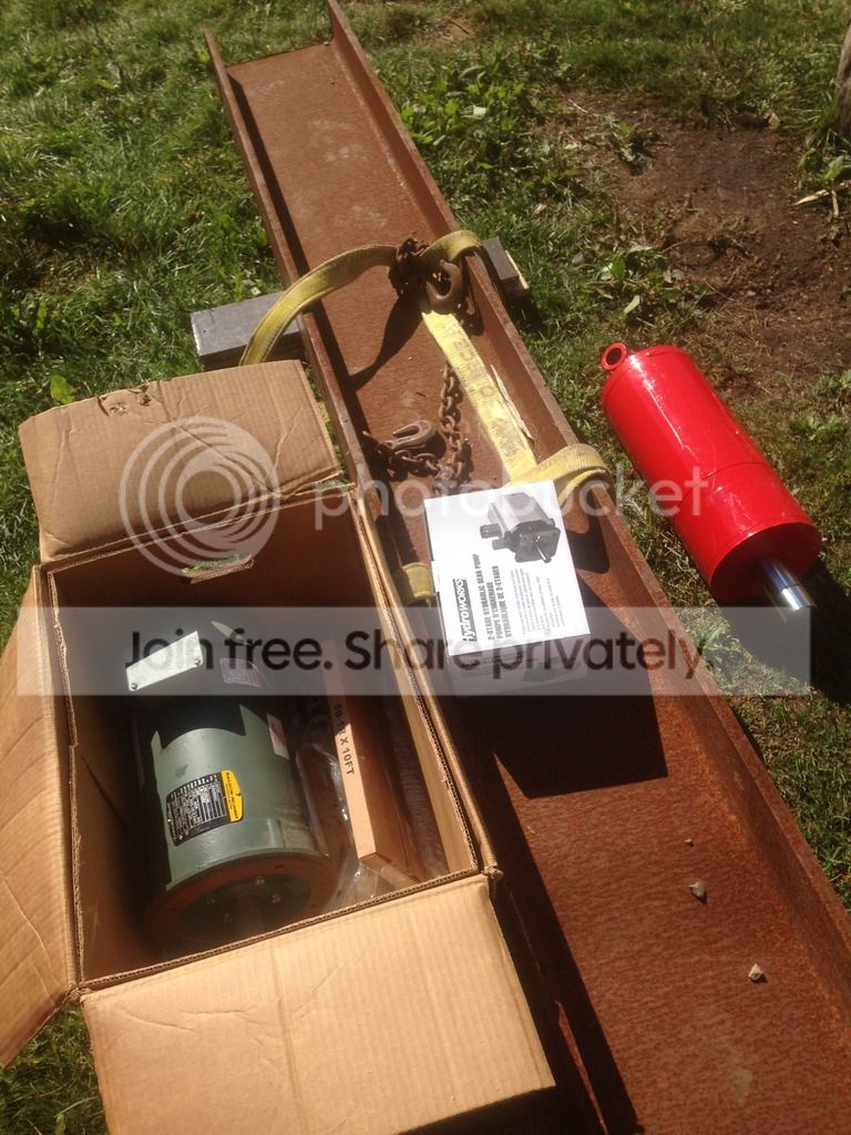

I see there was a parts list being emailed around but that looked like a long time ago. I picked up a hefty I-Beam today and plate and what not, the fabrication part (I think) I can handle, what I don't know however is the best set up to use. What pump, cylinder, motor etc.. to give me the best working press in the 25 tonne range with 2"/sec give or take? I'd rather only have to buy the stuff once.

Well, here's what I have gathered up so far. 7.5hp @3450rpm motor, 16gpm/4gpm 2 stage pump, and a 6"x 10" cylinder
I think that will rock. I just got mine going, I used a 5 hp 3450rpm motor with a 13/4 gpm pump. 5" bore cylinder. It's a beast. You have more hp, more gpm, but your cylinder is 6" bore. I think it will be great, have more power then mine. The little I have used mine, I haven't need more muscle, but it's not a bad thing.
Assuming your rod diameter is 2", your push force at 2500 psi would be about 35 tons. Extension speed at 16 gpm would be 2.2 ips, retract at 2.5 ips. Ram speed at your hi pressure stage would be .5 ips push, .6 ips retract.
To get a desired flow rate of 4 gpm at 2500 psi, you need 6.5 hp. To get 16 gpm at 500 psi, you need 5.2 hp. So, it looks like all your calcs are in line to run your press with that pump, up to 35 tons @ 2500 psi, with 2.2 ips extend speed of ram. Should be nice. You could get even a little more if you upped your pressure relief setting, but that decreases safety and I don't recommend it.
Now you need your tank with strainer and breather cap, pressure gauge, and a 16 gpm+ filter for your return line, plus all the high pressure hoses.

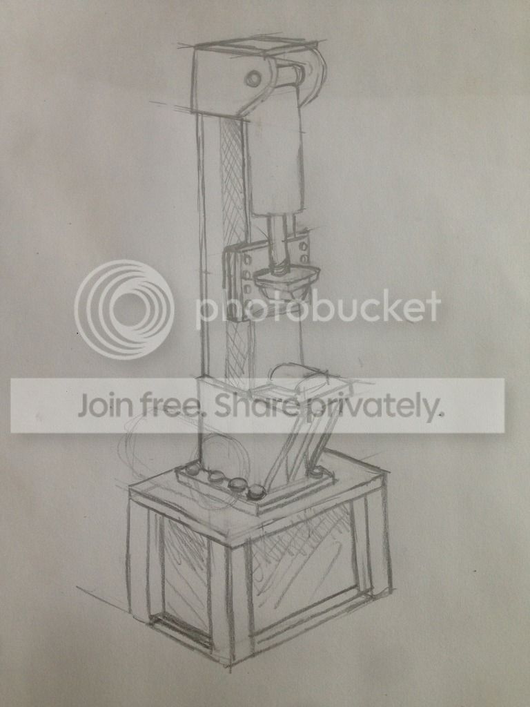

This is a quick mock up sketch of what the build may look like, obviously subject to change, probably a lot. sorry no CAD.. I'm a pencil kind of guy :)
I reckon 15 gallons or even a little less would be fine for your reservoir. You don't impart a whole lot of heat to the fluid, as much of the time you are only running at 4 gpm, and when running at 16 gpm your pressure is low. Also, your machine gets plenty of down time, even during extended forge sessions, as your heats are relatively short.
I like your drawing. Beats a computer sketch for style. The way you have your structure sketched looks plenty strong. I don't know what the web thickness is on your beam, but if you detect any curvature occurring in it under forging pressures, you can cut some extra 3/8" plates to fit into each side as gussets, in effect making a triple web I-beam out of it. I ended up doing that with mine, which made it a lot stiffer. The web on my I-beam was 1/2".
I think you can get away with just one stout bolt at each corner, on your mount to the stand (although 8 looks cool, you'll already be sick of drilling holes after making the slide).
Thanks Salem, the beam has 5/8" face wall with a 1/2" inside web, and 8wX12d
