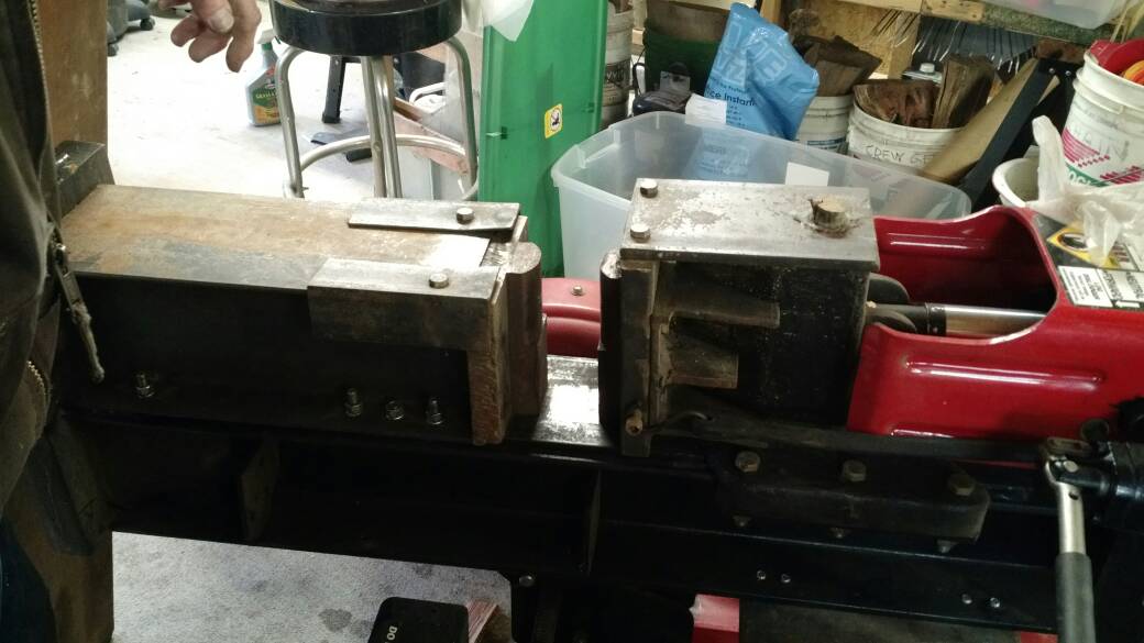

I was visiting my old Scoutmaster, who as luck would have it, is a blacksmith. He made some removable dies for his log splitter. I thought that was pretty clever.
