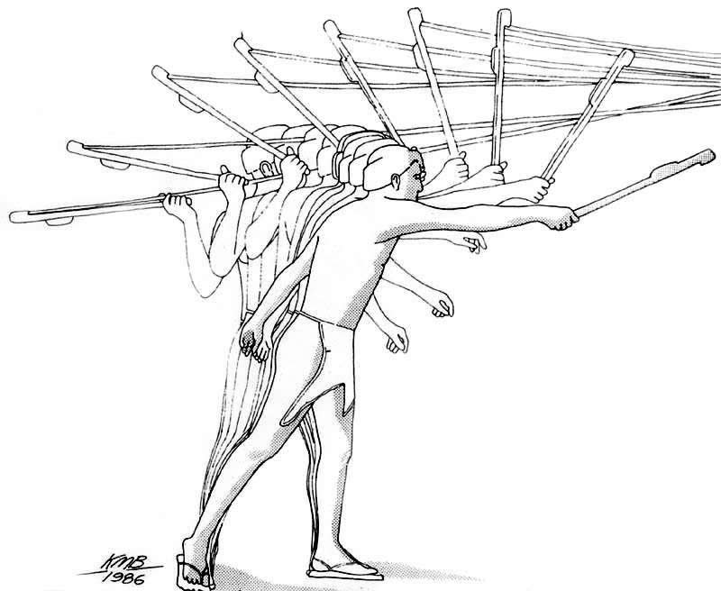

OK- I really wish you could sit down with me for a few moments, because some of this atlatl stuff is very easy to SHOW, but harder to DESCRIBE! I used to throw atlatls a whole lot- still do now but not as much. Also, I used to sell them.
Some of what I have learned...
#1 19" Is a magic number for me- 4" of handle, 1 inch for the hook, and 14" for the working section.
#2 A simple stick with a prong on it will work.
#3 It is MUCH more the thrower than the tool- good atlatlists can nail their target with poor gear.
#4 I like a little flex in the thrower, a little more in the dart.
#5 It is MUCH easier to get good flight if the dart is 5.5' or longer than if it is under 5'
#6 Dont try to throw hard at first, try to throw smooth
Have fun!!!
