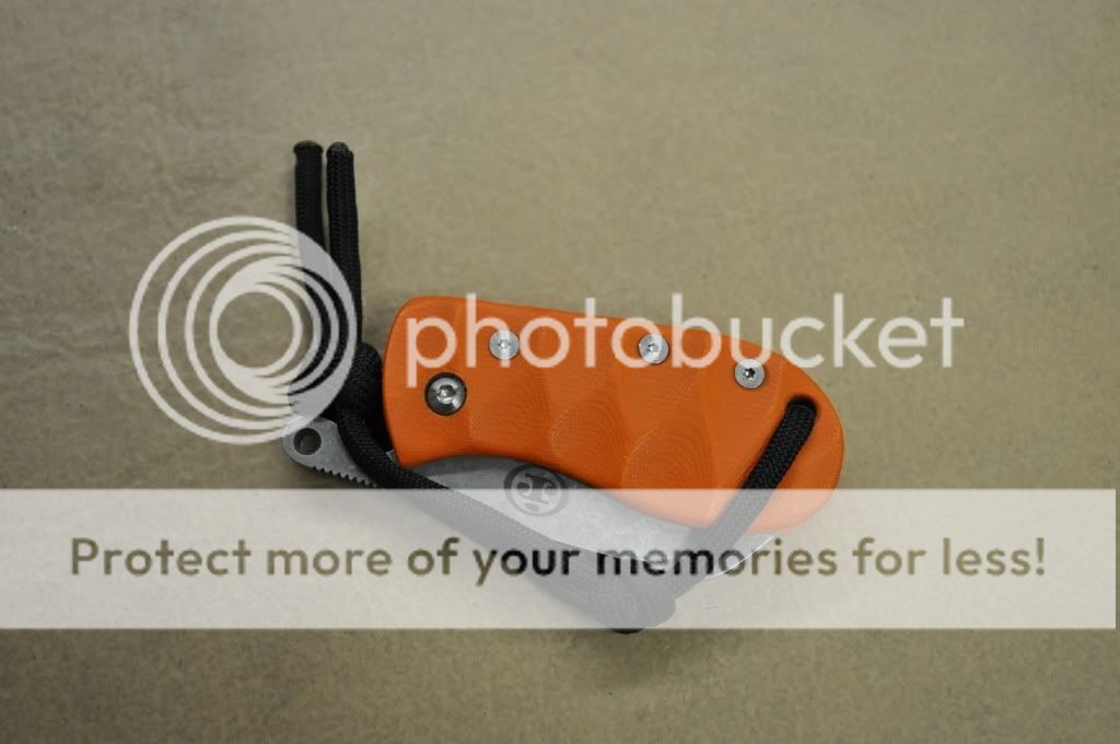

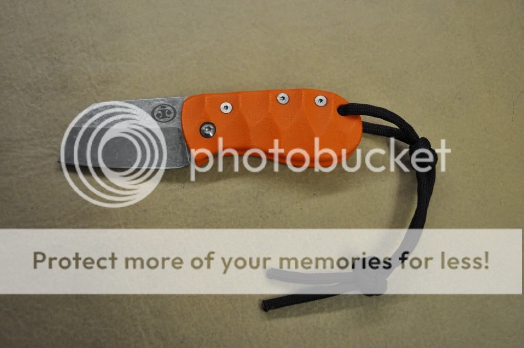

I don't think I would pocket it and if I did carry it, I would probably have a sheath made so I didn't have to worry. It is a friction folder, so you can adjust how much tension is on the blade with the pivot pin, even with just a small amount of tension, it stays shut pretty well. I'll post a picture later of a small friction folder that the knifemaker has tied a clever lanyard that fits around the exposed bar to keep it closed. It isn't ment to be a fast deploying blade, so having the pivot somewhat tight is a good thing. In the close to 50yrs I have been carrying pocket knives (slip joint, liner lock, frame lock, axis lock, autos, etc.) I haven't had any open in my pocket yet. The only problem I have had is with Emerson folders that have the "Wave feature", (with me at least) if I don't pull the knife out of my pocket fast to make the "Wave feature" deploy the blade fully to lock open, it only opens part way and I have cut myself because I didn't realize the position of the blade. I like Emersons a lot, just not the waved ones.
Here is a picture of the little friction folder I mentioned. It has a clever lanyard that wraps around the tail of the blade, works well.
