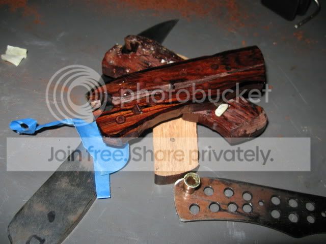

For today at least.. I was trying to flare a thong tube and it split the wood on both sides. :mad:Argghh.. I spent like 30 minutes sawing tha dang cocobolo block in half. Now I got to cut another one. My band saw crapped out and I got a wood saw only and no extra cash to get one either.:grumpy: Now I got glue all over my hands two broken sccales and ate a piece of humble pie. Mr Murphy rides again.
Well that felt better I will get back on it tomorrow.:cool:
I was using a c clamp and the heads of two screws like I seen on here before. I guess maybe the couter sink might have been too shallow. Next time I won't be so stupid as to not try a practice run before I ruin a nice piece of wood. Down here we call guys that don't think before they do something a special word. It starts with these four letters pend@%):D I guess it was me today. Everything was going so good and deteriorated pretty quick. Well thats enough about that....

Here are some pics of the carnage..

An effective way I found to flare a thong hole is to use and old counter sink. After the hole has been prepared and the tube has been checked for size and fit, glue it in and run the countersink backwards and press it into the hole. This will spin the flare rather than press it. You may need to make a backup piece to prevent pressing out the tube but this works great for me. Just a thought

Lube the screw heads with a little oil or grease,this will make them flare better and not squash and split your scales also make sure your countersink is deep enough in the scale.
Stan
You don't need clamps, screw heads, vises, etc.
Just get a tapered punch, countersink your holes slightly, cut the tubing 1/8" or less on each side, and tap the punch with a small hammer until one side flares. Then do the other side. File off excess.
Bill has it. It is not necessary to flare the end much at all. The glue will do most of the work, and the flare is mostly round the edge and cut down on lanyard wear. Also, make the hole a little loose on the tube. Too tight and it will split the scale. Countersink the lip about 1/16" deep and lightly flare the tube. Remember, you aren't making a plumbing fitting, just making a tube with a flared lip. You can make a flaring punch from a piece of round stock and do it by hand easily. Just grind the end into a round nosed punch, polish it, and tap gently with a light hammer. The advantage of flaring by hand with a punch as opposed to with some sort of flaring press, is that you can see the progress, touch up areas that need additional flaring, and quit when it is done.

I too, use a punch, to LIGHTLY flare it. Doesn't take much. You should only be able to see a hint of flare, any more and that's bad.
I then follow up with countersink bit to chamfer the inside edge of the tube so it does not wear on the thong.
Dan
FWIW, I don't flare tubes or peen pins (in fixed blades). With any decent epoxy and a little roughing of the outside, there is no way they should come loose. I'd be worried about the wood moving a little and a crack forming when the customer has the knife.
