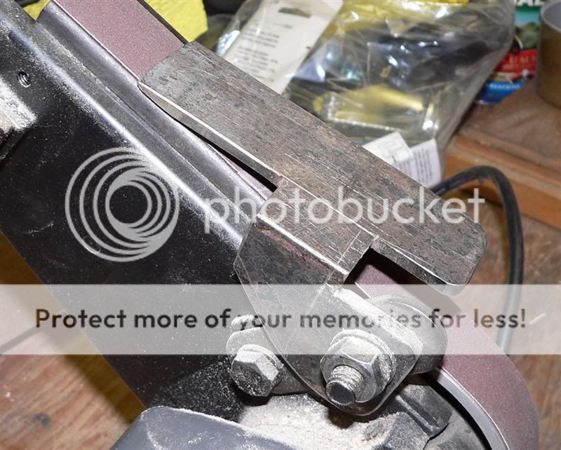

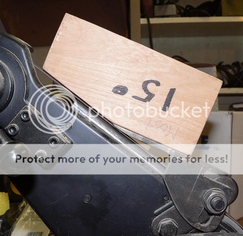

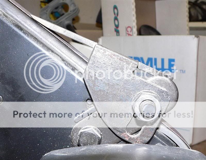

So I got this HUGE Kershaw Outcast in D2 for my wife to use dividing plants at the greenhouse... only problem is that the edge was VERY obtuse, and it wasn't doing the job.
Sooooo yesterday I went over to the in-laws, and took it along. My father-in-law used to sharpen knives as a side business, so I asked him if he could reprofile edge on his belt sander. He's got a little guide to keep the angle consistent, and he went carefully and slowly from 80 to 220 to 320 grit belts. He did in 20 minutes what would have probably taken me a month to do with a diamond stone! (incidentally, he said that reprofiling this knife was the most time he had ever had to take using his belt sander on a single knife... I guess that D2 really is pretty abrasion resistant)
It was just a little Craftsman benchtop sander , and he had added the guide himself. All I would have changed about his setup is to add some sort of slick tape to the guide so as to not scratch up the coating on the knife.
If I only had space for one of these things, I would be ordering one today.
