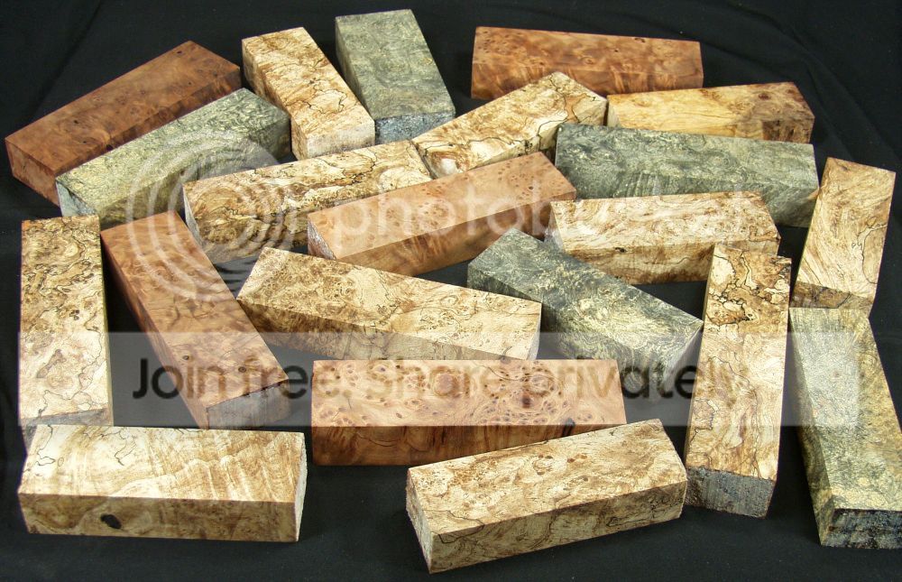

I am getting a lot of blocks ready for the Pasadena, CA show this month. As I am picking out pieces to cut I find that I keep cutting the weird, ugly stuff.
Sure I'll bring some pretty pieces but I really like the ugly stuff.
These are some of the blocks I stabilized and just finished sanding. Redwood, buckeye and maple.
I like the green ones, which wood is that? Being as new to knife making as I am I cannot tell one from the other yet. I personally like stuff that is different, not the norm.
Those are buckeye burl. Colors are grey and blue with a little gold. At first glance they do look a little greenish.
The maple and the buckeye are both woods that have spalted (started to decompose). They both start out as a white/gold color when fresh cut. When they start to decompose different types of bacteria form colonies that cause the different colors and black lines. It can form some pretty unusual abstract patterns. Normally spalted woods are too soft for most uses but by stabilizing the wood is made hard and durable enough for hard use knife handles.
Spalting is caused by fungi and not bacteria.
"Spalting" is the technical incipient stage of decay and once wood fiber becomes soft it's passed thru the spalt phase and is technically no longer spalted but into the rot phase.
OK, This is twice now that Larry has had to correct me about spalting being caused by fungi not bacteria. I must have some sort of mental block.

Wikipedia is good if one has some knowledge going into it. For example, it states blue stain fungi is spalting, but it is not a decay fungi..it's..well...a stain fungi and does not destroy wood fiber. We find blue stains in buckeye and pine for example. Sapwood spalts, but generally not heartwood because sapwood does not have repelling extractives that form after sapwood becomes heartwood. Maple is mostly sapwood as is birch and beech. I have seen true spalted walnut and koa heartwood, however..only once each in 20 years.
