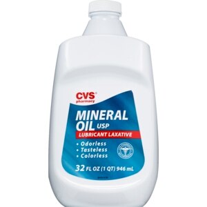

My problem is I have no idea what oil to use. I already spend an afternoon on the computer trying to figure out what you people mean by "mineral oil" for use as lubricant.
I know it's not the stuff you put in the pan like olive oil and it's supposed to be available at the drug store. I'm not planning to buy expensive oil on Ebay every time (high shipping cost)

edit: [the kid] - yes, cheap mineral oil from grocery & drug-store. e.g. Walgreens mineral oil (google it)

Look for 'Mineral Oil USP' in the pharmacy section at the grocery/drug store. It's commonly sold as a laxative, and therefore will be found in that aisle. In hardware stores, any simple 'light mineral oils' or 'white' mineral oils (basically implies the same thing) also work well. All of them are very inexpensive (if it's pricey, I'd avoid it anyway).

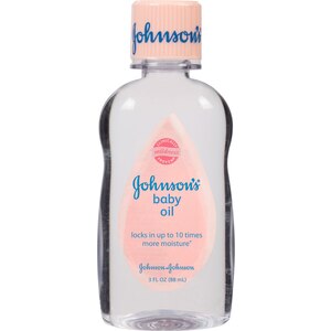

Can also use baby oil, which is just light mineral oil with some scent added.

Thank you! Especially baby oil is something which translate directly (no particular brand) and I can ask for. And have nice smelling knives as well.:thumbup:
The laxative oil is also a good tip but I rather not have to ask for it at the pharmacy. Even though I could say it's not for myself. :cool:

The 'laxative' grade mineral oil is also sometimes called 'heavy' mineral oil, because it's a bit thicker (more viscous) in consistency. This is sometimes a factor to consider in deciding if you like it or not. But any one of these will get the job done. :)
