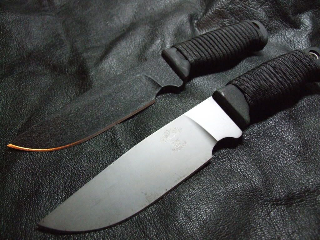

As others have stated, your question is pretty broad. So, I can only offer my own opinion. For me, I prefer something medium sized as a "survival knife". I prefer something with excellent steel and a manageable size but that could be used hard without concern.
These are my Scrapyard Dumpster Mutts. They can be had for less than $150 and are, what I consider, "hard use knives".
Of course there are many other choices as well. Good luck in choosing.
