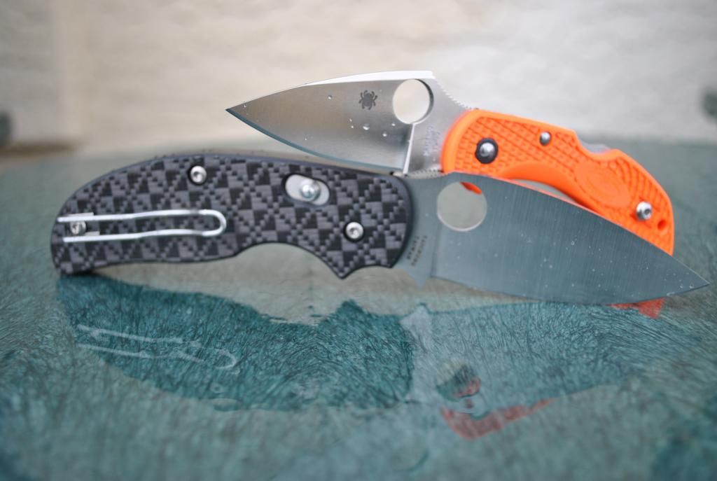

Hey guys,
I'm really interested in the Sage 3 in carbon fiber, but I can't seem to find anything on Youtube about it (I'll always watch reviews on a knife before making a decision, to get a better look of it and hear people's opinions). Since it's a new design, their isn't much info about it on the web. Does it have liners? If you guys could provide me some pictures of it I'd really appreciate it. I'd also like to hear your personal opinion on it and your opinion of it compared to other Sages.
Thanks!

No liners...it's definitely my smoothest Spyderco, but I don't have many pictures of it yet. I'll snap a few more in a bit and post them back here for you.
Yes it does have recessed liners like the paramilitary 2 has!
I think the sage 3 is among the most under priced and under rated Spydercos to date. The new sage 3 with CF scales is a little less grippy than the blue g10 version but more than adaquate. I can't give you a comparison to the other sages because I own the S3s (2 g10 and 1 CF) due to my dislike of mid locks, frame locks and liners locks. I can say if you like the benchmade axis lock at all then definitely try a S3! The fit and finish on all of my Taichung Taiwan models has been absolutely perfect to a point I didn't think possible on a production folder. If you were to take a benchmade griptillian apart then do likewise to a sage 3; you would expect a $100 price difference not $20. That said the sage 3 is not for the faint of heart to disassemble. There are many smaller machined parts. If you get one use dry lube or no lube at all. Otherwise grit gets stuck and is not as easily flushed out as an open back design. The full back spacer makes the knife feel great in hand and looks almost seamlessly machined. The great deal of machine work in the knife is in large part why I like it so much. I used to work as a machinist and it blows my mind that they can sell this knife for around $130. OK enough rambling!

Yes the liners are milled out making a knife supprisingly light for its size and construction. I agree with you on the black g10 and dark clip would be awesome. I wouldn't worry about the closed back construction, just don't use wet oils to lube the pivot. I did this with my first S3 and it got gritty from dirt sticking to the oil. Since cleaning ive used tuff glide and not had any problems with a gritty action. If you are dead set against the closed back then take a look at the g10 manix 2 which is another great knife. Whatever you get I doubt it will be your last spyderco!

No rattles here either in my 3 examples. I'd be curious to know where the rattling is coming from. My guess is one of the studs for the lock has loosened a little. Each of the studs are a separate threaded peice that thread into a barrel going through the bolt. The studs are what keep the cover plates tight. One or both of these plates are what I suspect you are hearing rattle.
