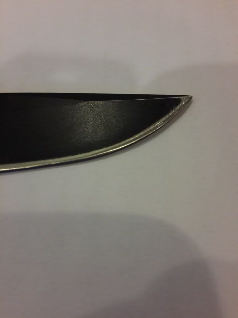

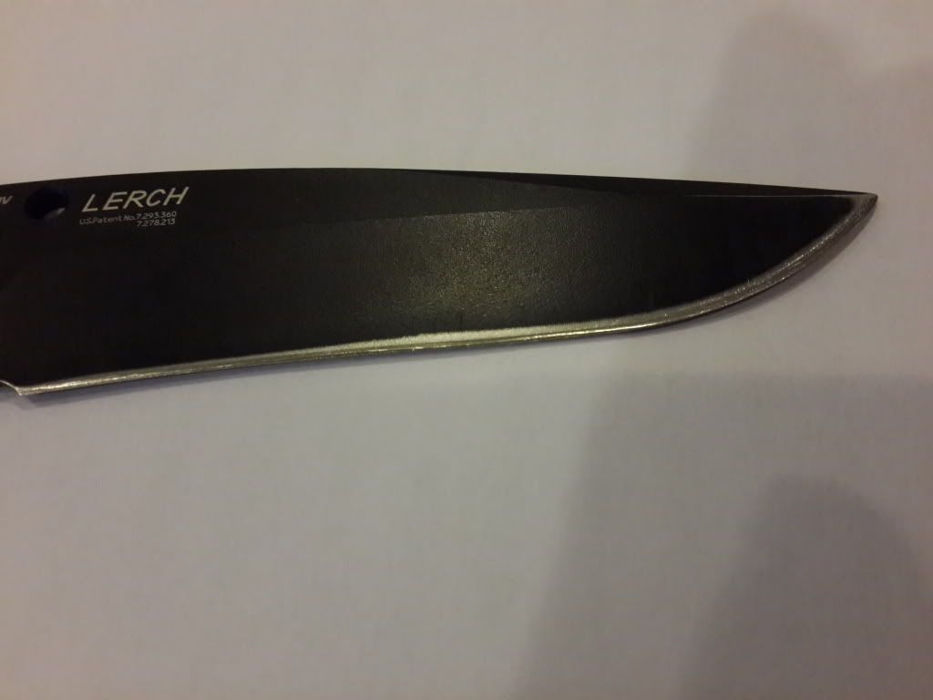

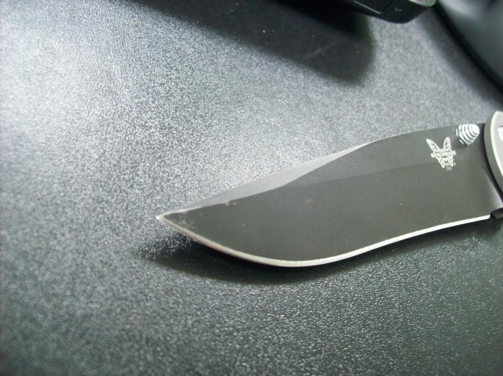

This happened to me about two years ago, the pictures show my blade worn not from use but from sharpening, it was my first S30V knife and I bought all kinds of sharpeners ceramic, diamond. aluminium oxide, leather strop, white compound, green compound, even accusharp, damaged the blade completely; shortening it, completely rounded the tip, made the recurve disappear, still couldn't get the knife to be sharp.
But I used the blade to practice, what I found out is I always use a very low angle because I always believed it will give me a sharper blade, but don't need a blade that sharp and since I'm doing it free hand I do not keep a perfect angle.
Now I have learned that it is better to use a higher angle and keep your wrist as steady as possible no need to be absolutely the same angle on both side but try to keep it consistent, slight variations are fine, you may slightly convex the bevel but you will still get an edge sharp enough to cut newsprint. Presently I use only a medium ceramic stone, a fine ceramic stone, and a untreated leather strop with no compound.
Credit to Benchmade's customer service, they send me a replacement blade half way around the world, the scratches on the blade are now from use, the bevel is a bit convexed from free hand but usually I can get this knife from dull to cutting newsprint in 10 mins.
