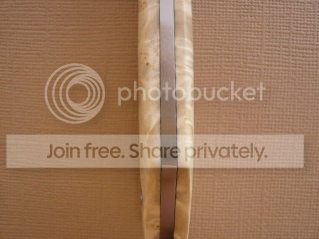

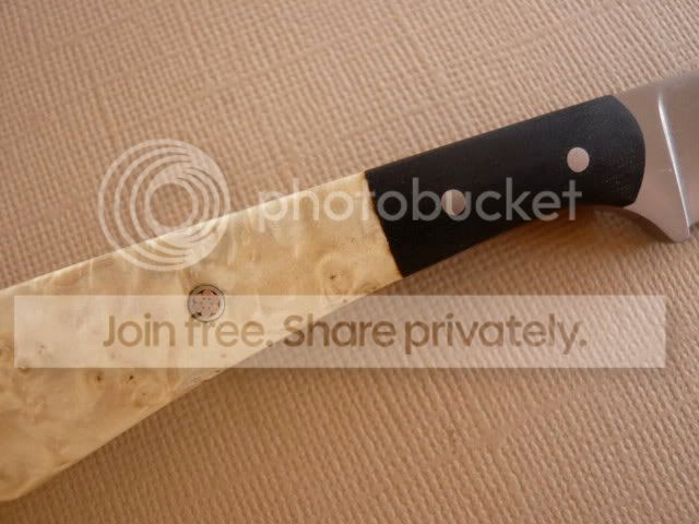

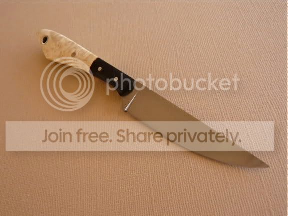

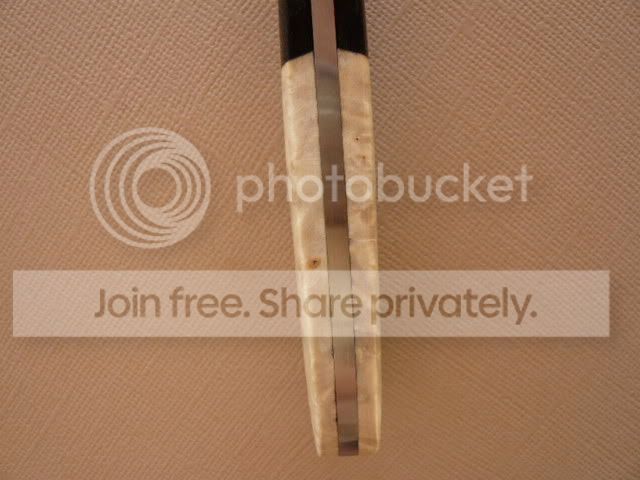

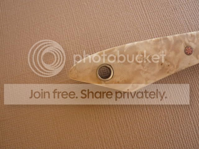

Here's a couple of shots of the offending areas. I think I managed to clean up a lot of the stained areas with steel wool, although it's not 100% perfect. I think I will Danish oil it, maybe post some more pics for input, then make a decision about what to do (ie, do I have time to re-do it, should I just keep it and be better prepared for next year's KITH, etc., etc.)
I'd take it.Put about 6 coats of Danish oil on it,let it sit for about 4 days then buff it with a terry towel.\
What do you use to flatten your scales.use a granite plate or a thick piece of glass and sand gently to get them to fit up.
Stan
Thanks guys. It's had 3 coats of Danish oil so far today, and the figure in the wood is coming out better but so (unfortunately) is some of the staining and dark areas.
I usually sand scales by hand with 60x or so on a marble cutting board (my poorman's granite surface plate.) My test for flatness is I hold them against the tang up to the sunlight, and if I can't see any light come through I consider them done. I did the same with these, but since they were warped and more rough than what I usually start with, I first worked on them on a 60x belt on my platen, then did the hand sanding thing. These passed the sunlight test, but it seems I need a new criteria for determining flatness. I've never had noticeable gaps before now, but I've also never worked with light handle material before and perhaps it's just much more evident with light woods.
The scorching at the bolster came from my disc sander that I used to make the dovetail. I saw that the wood was scorched, but I convinced myself that since it was just the bolster mating surface, it would not be visible. I won't be making that mistake again.
Check your cutting board with a straight edge,it may not be real flat,may have small dips and valley's in it.If it does go to a glass shop and get a piece of thick glass,usually they will give you a piece of scrap.Also check out some place that makes granite counter tops,they too will often just give you scraps and they are usually pretty flat.
Stan
Good idea, Stan, I'll check that out right away. As far as checking flatness of the scale itself goes, it seems like my sunlight test ought to work, but it appears to have failed me this time. How do others verify scale flatness before glue up? Straight edge again? Also, what to what grit do you sand them? I usually leave them at only 60x or so, but could that be part of the problem too (ie, too coarse)?
Myself, I sand to 220. I think 60 is a bit rough. I get them pretty flat on my 4X36 sander and check them the same way you do.
I have a piece of Marble Tile I got from the tile store for free.
I guess the only place it really counts is where the scales meet the very edge of the tang. It might be when you push the scale on the sandpaper the leading edge is getting a little rounded and this is where it would meet the edge of the tang. Just because no daylight is showing through does not mean the edge of the scale is flat onto the tang. Cheers Ron.
