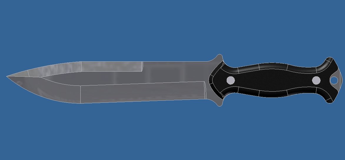

3D version of Dan's sketch
I think the tip geometry on this one looks significantly better than my previous iterations.
I've done some thinking about the handle - and agree that an asymmetrical butt would be a good idea - easier to use for chopping/slashing...yet, the handle will remain symmetrical up to that point for comfy reverse grip.

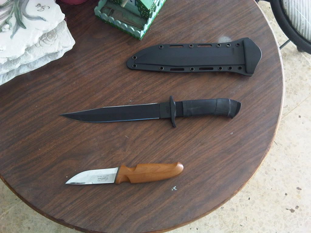

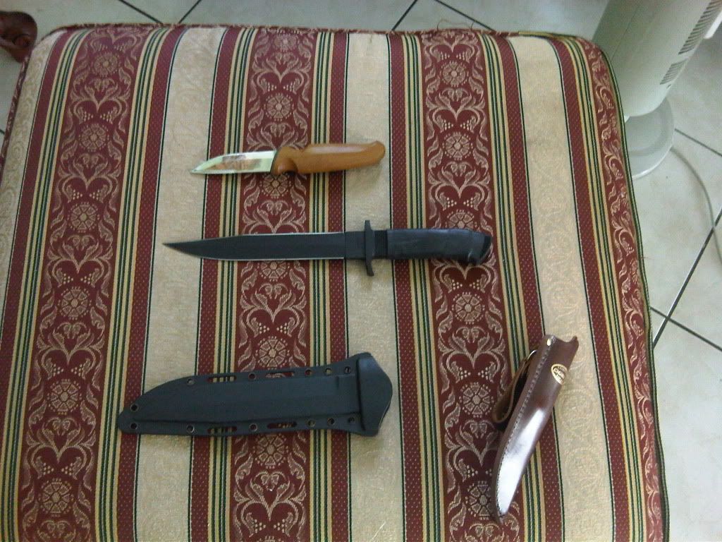

Here is an idea or 2 and if I may be so bold:
I have a CS OSS which used to be a sub-hilt and had pronounced guards, since they are made of rubber I trimmed to taste
Is 8", the handle favors 1 grip style but offers a belly to slash and a super sharp point, it can be made as heavy or a light as you like by changing the grind or width of the blade, I have 2 models and 1 of them looks like another generation as is wider and heavier. I added an inner tube for grip but you can work that with another choice of grip material.

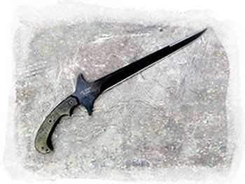

Another idea which I love is the Dueling knife from Laci Szabo
If you are thinking of a fighting knife it's got to be light and fast IMO, imagine a guy with a rapier fighting a guy with a broadsword, unless they are wearing armor the rapier is faster on target and recovery.
