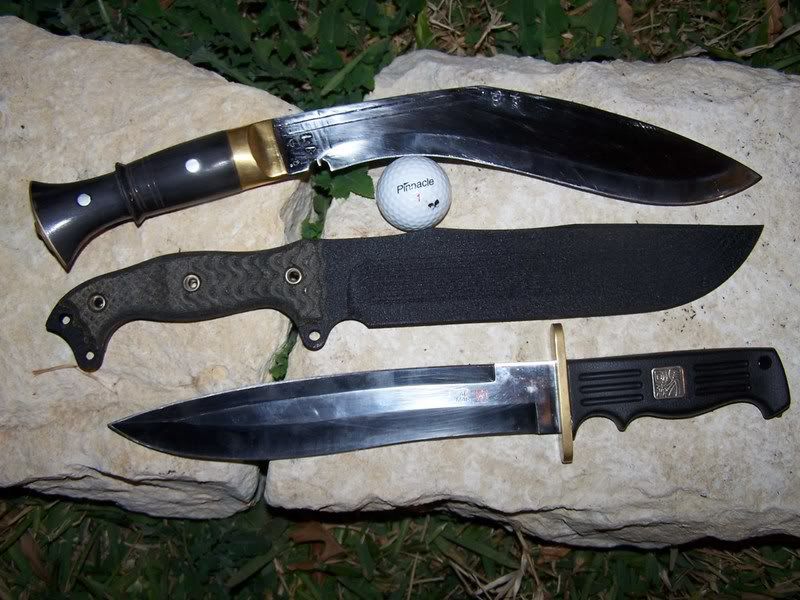

I found the one from Mineral Mountain Hatchet Works had a lot of appeal. Ted has since changed this so its not done quite like this now. Mine is a rather old one. Here it is fresh back from Ted with a new refreshed finish and new kydex sheath. A double edge combined with a very profound "Skull Crusher" (what Ted calls this model) pommel is something I think of as necessities in a fighter model.

The FS dagger and the SOG do not really fit the 'profile' for the type of use Dan has specified. Those blades are too narrow and likely too light and neutrally balanced to be able to be affective at much beyond straight fighting and would really be poor choices for door breaching and most field tasks.
I think a knife akin to what Alfaholic posted would be a better option for the stated use. Maybe we will see something like this in the future as a different offering.
The last thing I would use a dagger type blade for is door breaching. Plus to the extent of my training I'm not going to put the time into breaching a door involved with slinging my rifle back, unsheathing a knife and prying the door open, then having an open door holding a knife. Its my understanding that in "tactical" situations your knife will be used as a last resort.
I guess perhaps "fighter" is misleading....because, yes, a true fighter would be an "Arkansas Toothpick" style. But I am less interested in that, than I am a "Combat Fighter". In other words, something I would have no problem sending out across the pond to the sandbox knowing it would be used for everything from stabbing/slashing to opening doors....that could be used wet or dry....could handle a fair amount of abuse and have enough weight to do damage to whatever is on the receiving end of it.
