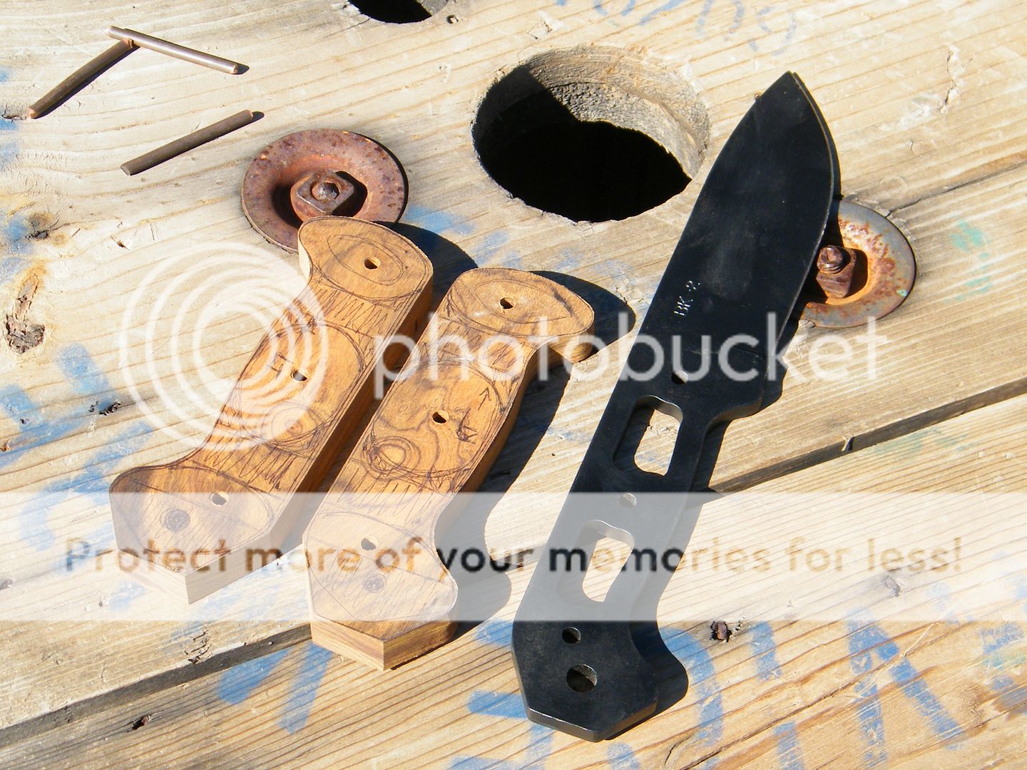

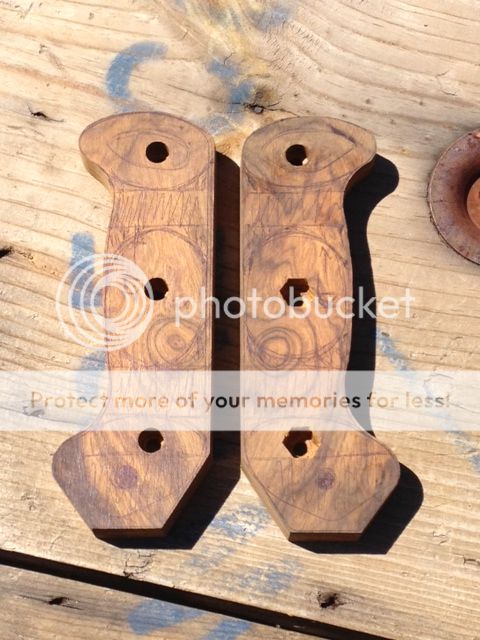

Okay, so I got a 2" x 2" x 6" block of desert ironwood, and match booked it into 3 @ 5/8" thick x 2" x 6" blanks (1 is spare in case mistake)
Also I was able to pick the best 2 of 3 for the slabs.
I am considering trying the hexnut thing on one scale so I can put these on different Beckers :) Does anyone have a helpful link or hint on doing that?
They are sanded at 80 grit right now and will highly polish up with higher grits and buffing coumpound. I have a lot of shaping to do as well.
What do you think so far?

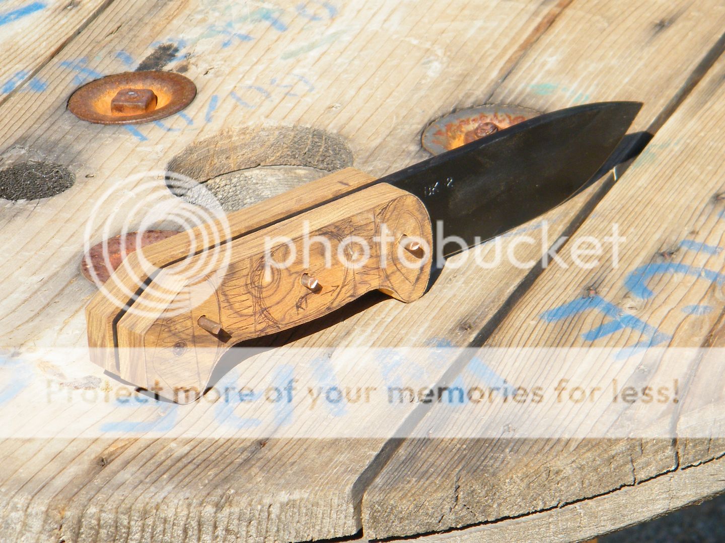

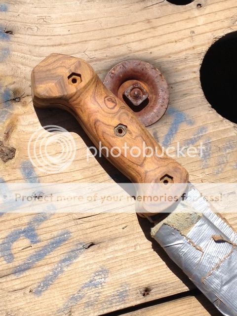

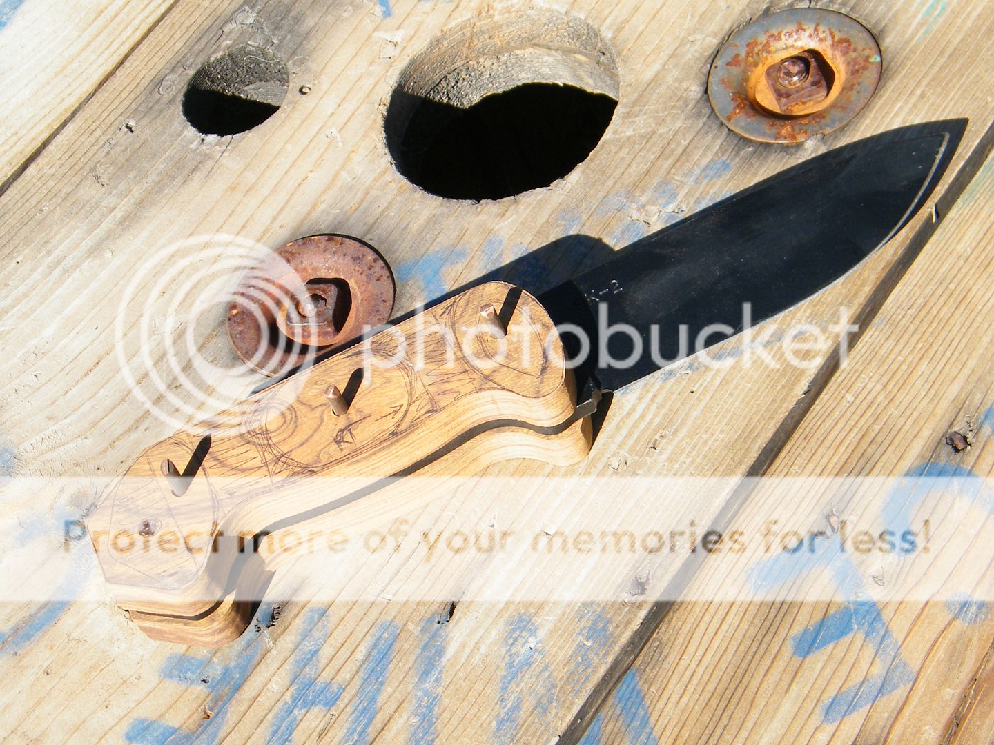

Here are some progress pics.

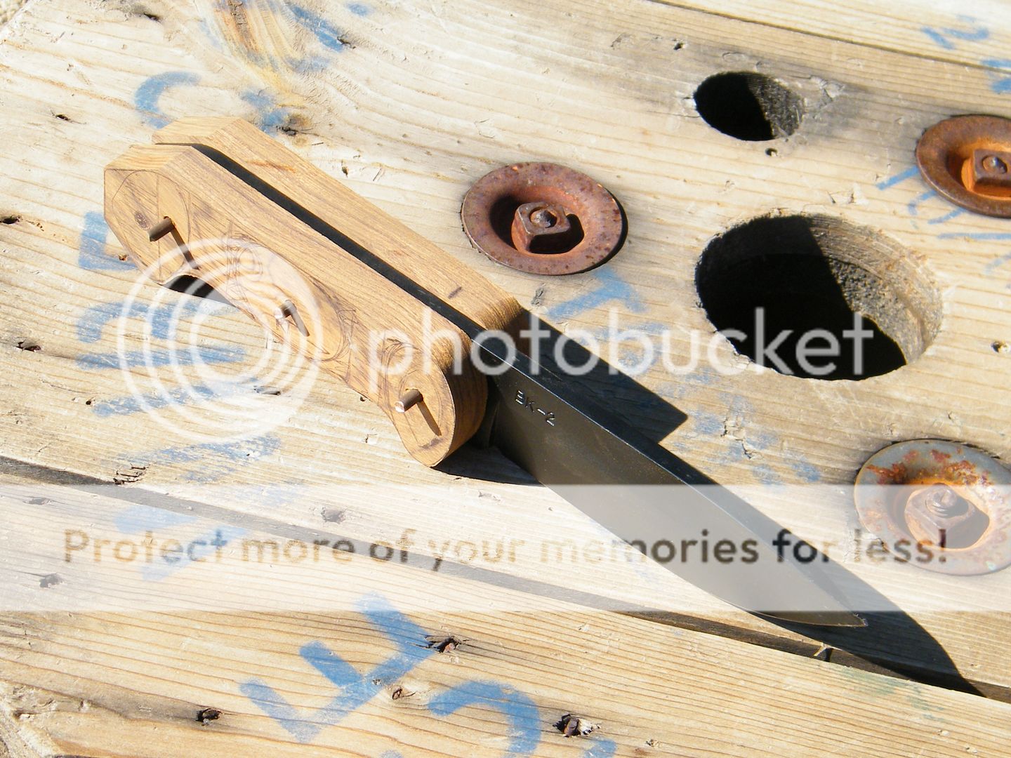

Getting hardware started. I used a sharpened screw driver as a chisel. I chisel ground it and narrowed it's shoulders for the hex nut part.
A little shaping. This is my first attempt at handle scales ever. So I am green at this and scared:eek: And I'm using desert ironwood for my first attempt, and it's hard like a rock. And my sander is only 1" wide. :)

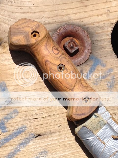

Getting closer

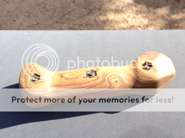

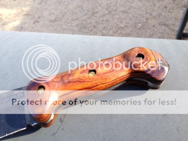

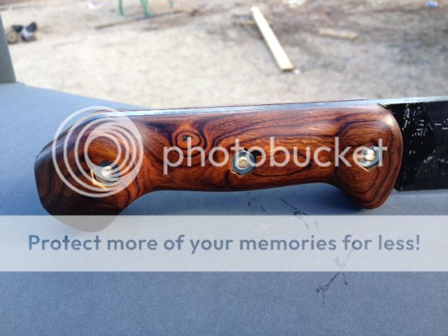

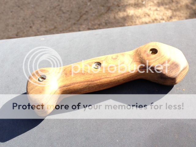

Here are few with some mineral oil on them.
I need new hardware in black like the factory just longer :) and I will continue shaping them as time goes on. They are only sanded to 150 grit right now. I need to get some higher grit sand paper and the proper oil n stuff and I think they will work for me.
And I am really happy they will fit some other Beckers too.
