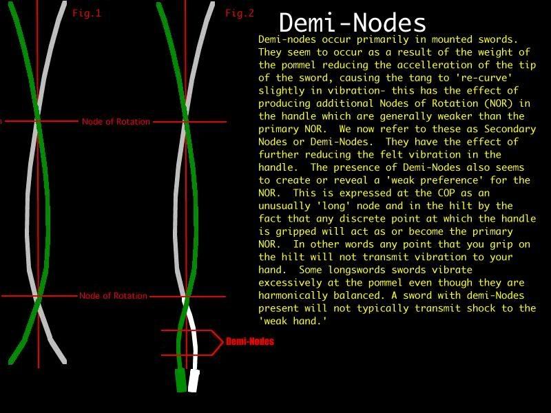

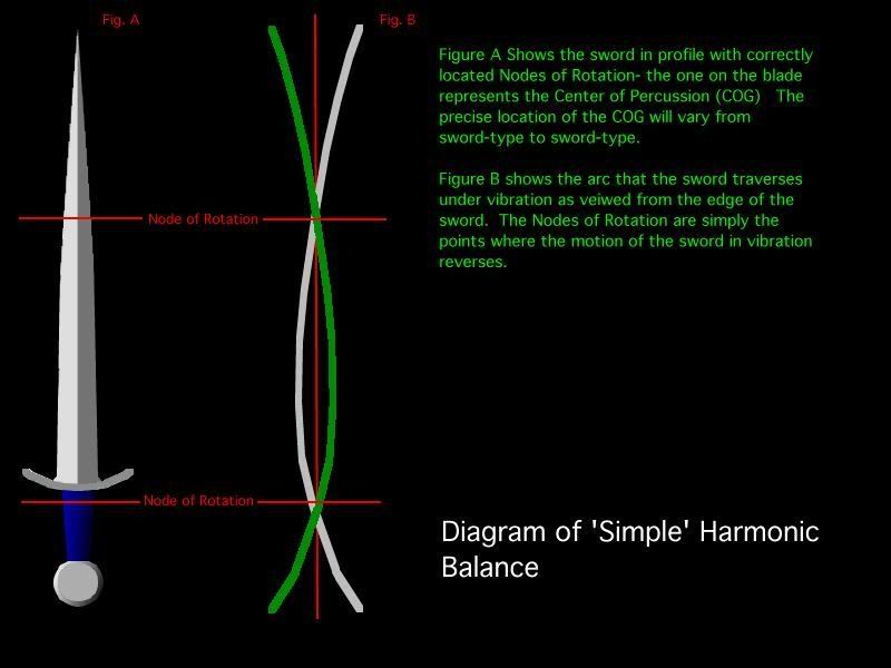

Ok so I did a little poking around at SFI and found a pic that tinker put up.
There is a typo he uses COG (center of Gravity) to describe COP (center of percussion).
Take note of the placement of the node at the handle.
I agree that this is "Balancing" that is getting the placement of the nodes correct, also I add dampening the wave amplitude as part of the "balancing"
It depict's the Fundemental Frequency rather well.
Very good picture
Here is a second one on "complex" harmonics. It depics the effects of a heavy pommel.
