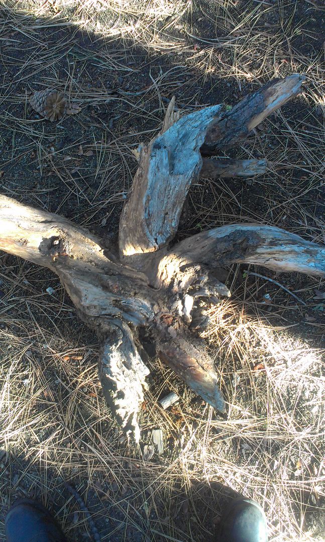

As I understand it, many burls are created from insect infestation. If that's true, might try looking for those.
I saw this piece while out in the woods.
Not sure if it would have been worth taking and didn't have a saw.
While on the subject of odd wood choices, has anyone ever used "mountain mahogany" it's all over the place out here in high desert N.
Cali... kinda cool looking scraggly old trees, slow growing and relatively hard... or juniper for that matter?
