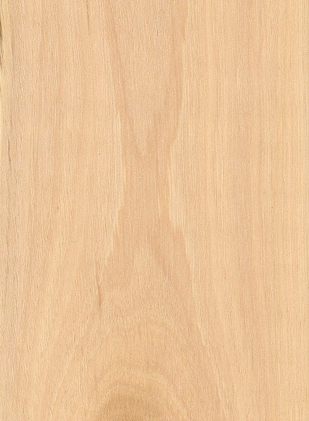

I don't really mind the wait, but my cousin is really impatient!! I think I want unique, so i'll look for a wedge. Hopefully there is a dead branch or something we can use!
Apple boards move (bend/twist) like crazy as they dry unless you get a piece from a straight vertical (and boring) trunk. Small slivers of any type of wood season pretty quick in the oven at 200 F and you can always true them up on a piece of coarse sandpaper attached to a flat surface.
Thanks for the tip and heads up. I really want to use apple, so hopefully I can find a piece that doesnt go all crazy or check on me too badly.
It is a little harder to find in the forest, but you might want to look for some American Hornbeam trees. This is sometimes called Eastern Ironwood and is a really hard durable wood. I like using it for hiking sticks and tool handles. You can find them growing in the soft soils in creek bottoms. They don't get very big, but you can harvest a five or six inch tree and get a lot of useful "craft" wood from it (no big lumber, but lots of useful blocks).
TedP
I'm quite familiar with Ironwood, but have yet to find it on our property. I quickly surveyed it when attempting to make a longbow (ask me how that project went...). There are a few creek bottoms but they're at the bottom of very steep hills and I don't like going down them, let alone bringing additional weight up! :eek:
