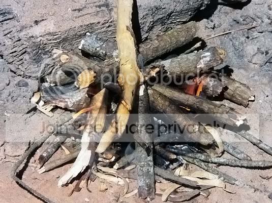

Next I gathered up a few of the smaller diameter limbs that were laying on the ground and headed back to the firepit of our lodge. Using both the serrated and plain edges of the blade, I shaved enough from one of the small limbs to act as tinder and broke the rest into 4-6" pieces. I was a bit disappointed in how the serrated part of the blade performed when shaving the wood. Not that it did a bad job, it just didn't perform as well as the plain edge.
I place some dry grass in the firepit and made a not so tidy pile with the shavings and used the back of the saw to strike up sparks with the BSA Hotspark, easily igniting the grass and shavings. Then I started building up the fire until I had flames working at the larger of the pieces.

Longbow50 I am not surprised a seiously serrated blade would be bad at shaving . I am impressed with the saw . I guess thats about a big a branch as it could handle ?
It did OK at shaving, but it was difficult to control the depth of the cuts. The serrated section did fine scraping fatwood and making a powder to ignite with the Hotspark.
