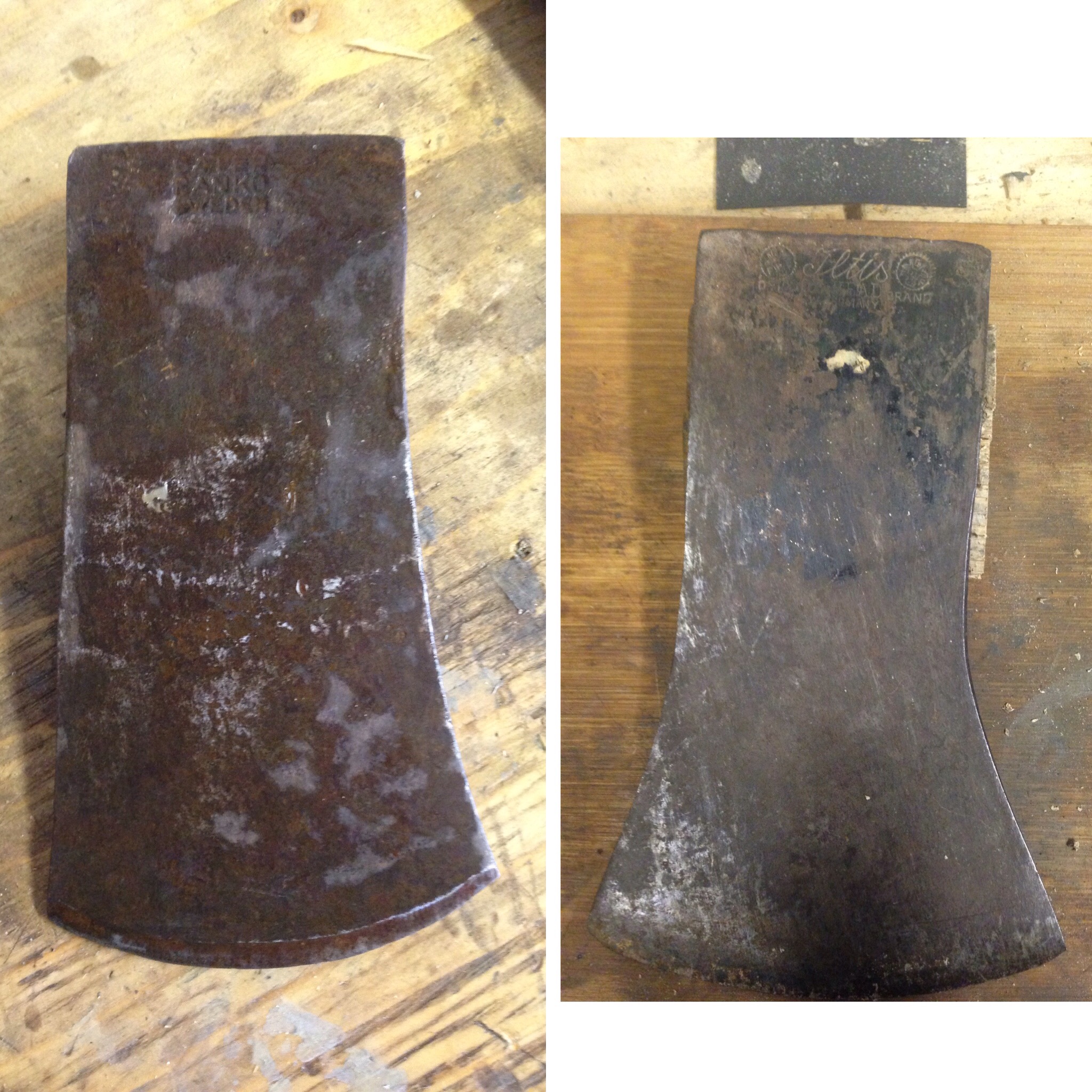

Errrrr, You do know the head is upside down right? Script should be read from top to bottom standing on the haft. Yours reads from bottom to top..... The "Orig" needs to be on the top side.
Good spotting and you're correct. By convention stamps are generally (95% of the time) on the left (port as opposed to starboard) side of the head and the two Iltis heads I have are like that. Some heads are symmetrical (same sweep of the blade at the toe and at the heel) and if your's is one of these just leave it be. If the eye is tapered for wedging purposes you may inevitably run into some problems but if not who cares.
Yea i realized that last night (viewing the pics)....silly mistake for a first hang. Oh well off it comes i will re do it but i think im going to do some looking around for a better shaped handle as this one is ok but im sure there are better. (I was in a rush for some reason lol) it was quite enjoyable and I actually look forward to doing it again (but better) this time.

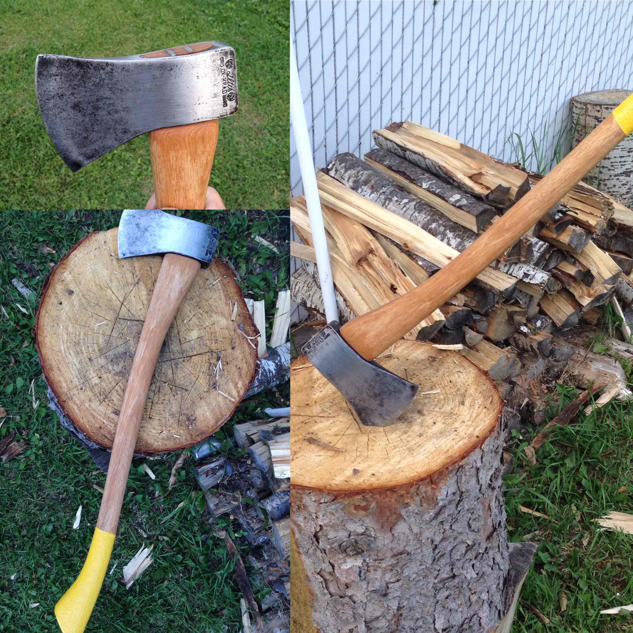

Well this looks better, I put a new handle on and it is mint, i like the textured yellow handle, hard to loose that in the bush(my new limbing axe) and its close to the original handle that was on it. I was able to save most of the other handle and it will give me a reason to keep an eye out for another old head ;)

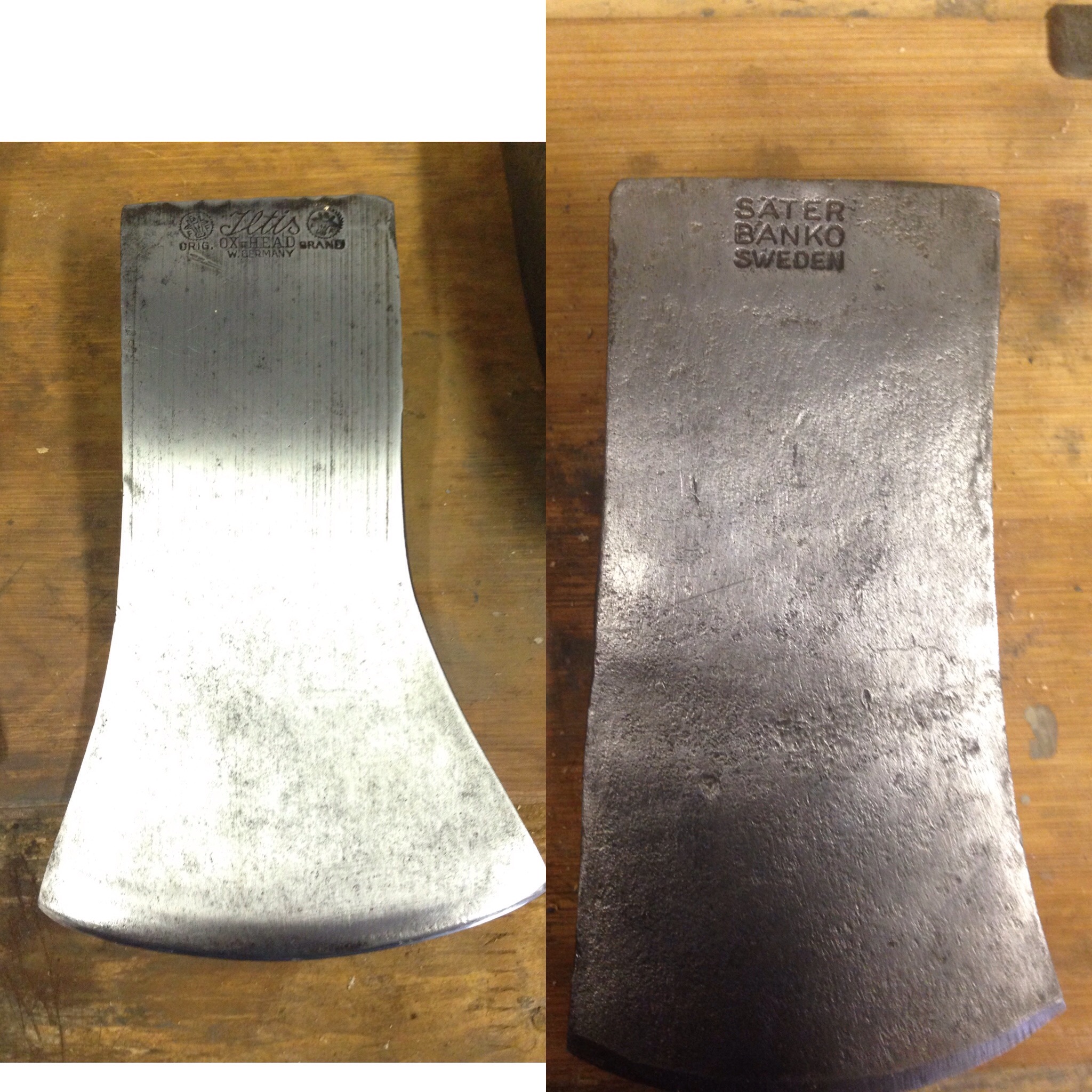

Some of those Sater's are pretty nice. They went out of business about the time manufactures started cutting corners.
Its in quite good shape with the layer of rust removed. The edge looks like it hasnt been used yet. Think i may turn that guy into a smaller hatchet.
