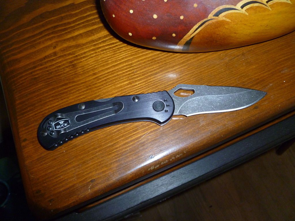

OK, got it in the mail today from SKBlades. Yeah...pretty bad up and down blade play. Almost as bad as a $5 Auto I bought years ago. So, is there any way to adjust it out?
BTW, JayC783's take on his is the same as mine, except where bold....and same date.
Black Spitfire:
  • The date on the box says 10-31-16
  • Gritty-ish action
  • Tight lockup
  • Some vertical blade play. It's nothing major (I would say mine is worse), but it's enough for me to notice it. It's become a minor annoyance. I find myself fidgeting with the blade moving it up and down while it is locked open. :o It was especially noticeable when I was cutting some zip ties. The orange one did not produce this feeling when I cut zip ties with it.
  • The edges and jimping on the handle feel a bit more aggressive than on the orange Spitfire. It's not uncomfortable by any means, but it's noticeable. (Mine feels real sharp...feels as if I was cutting something aggressivly, it might break skin)
  • When locked open, the lockbar sticks farther above the handle than with the orange Spitfire. On the orange one, the lockbar is pretty much flush with the handle when the blade is locked open. The lockbar is easier to push down on the black one, too.
  • The main pivot screw moves up and down ever so slightly when the blade is locked open, and I move the blade up and down. The orange one does not do that.
  • The same pivot screw, and the insert it's screwed into, can be rotated slightly by just pushing it. The orange one does not do that.
Here it is....cause no pictures, no bueno.
