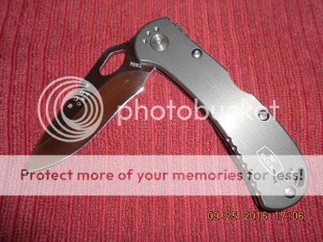

I just read through this thread today. Since I own a Grey Spitfire 722, thought I add a few pennies worth of comments.
I really like mine -- solid, no up/down blade play whatsoever, scary sharp, smooth opening, tight lock up --- overall works excellently! Plus it is one very sharp-looking blade! Here is my knife:
In the very first post, my Buck description is very much like the description JayC783 provided of his orange Spitfire --- everything is A-OK. Interesting that the date on my box is 03-03-16, just 4 days different than JayC783's box date. He ended his first post by saying:

I must be one of the fortunate buyers that ran into a well-made 722 when the QC was ramped up. That's all I can see that the issue appears to be --- errant QC. QC is very tough to maintain, and takes much vigilance. So it appears there have been too many misses on this knife. I feel bad & sad for those folk, who don't have a watched-over, QC-handled Spitfire. That is not a fun thing for sure.
