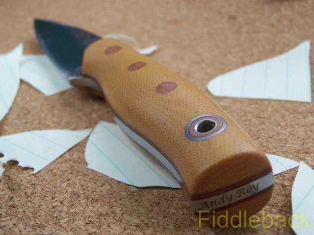

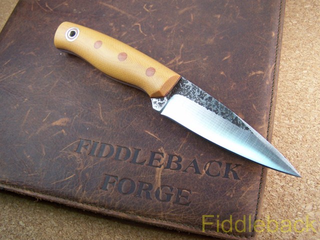

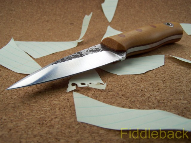

It's a purty knife, but not a garter knife. Taper the tang, thin the scales and forge in the bevels for more distal taper to the point would reduce the weight by nearly half.........nothing worse than a droopy garter on a well turned leg!

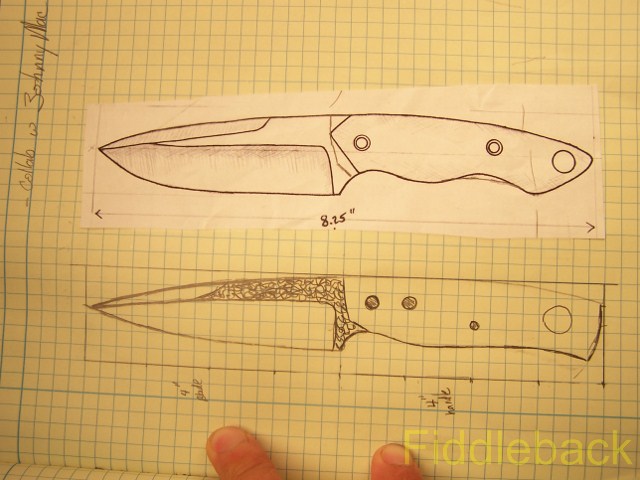

Nice work gents! Both sketches and Andy's prototype look awsome, but just incase you're looking for feedback, I like Johnny's blade shape better, and Andy's handle.

I'll taper the tang on a batch of them just to suit your fancy. Its that time of year anyway. Gotta proove I can do it once a year.
