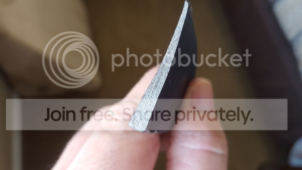

USA made. cross section of blade
I am not surprised to see this. My BK16 looked similar when I broke about 1/2 inch off the tip.
A properly heat treated O1 blade will do 99% of knife related tasks. I would put my NWA (diff heat treated spine around 50 and edge at 61) in the same category toughness wise as my RMD. Both of these can take a beating. Edge retention is similar on both.
If enough force can be focused onto a very small area then something is going to give. Steel hammer onto steel can cause some interesting harmonics that only add to the steel's stresses. Tempered hard then its going to crack, tempered soft and elastic its going to roll or squidge.
We want our knives to have hard edges so they don't wear. We want our knives soft so they don't snap. We select the steels that show good qualities and each is biased to one way or the other and a lot depends on the heat treatment processes to get the most from whatever steel to do compliment the compromises we want. Some makers get it more right than others.
Broken knives are generally from overwhelming the steels limitations. From all the compromises made to get a knife finished there is still some "luck" built in. Luck in the steel, luck in the build when some process never took, luck in the use its put to. The BK16 above may have given years and years of service but ran out of luck because it was Cobalt's! It was given a task that it might never encountered in another life and reached its limit. Thousands of USMC Kar Bars have been made, bought and used and no one would argue that they haven't given sterling service. Sure some met their limit and ran out of luck, but some are real veterans too.
