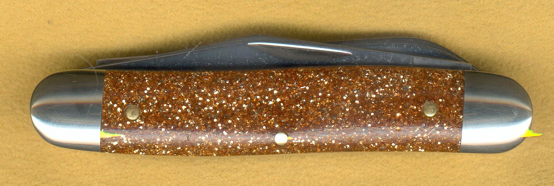

Since I lack the skills to make knives, and at 66 years, with a touch of arthritis, and other sins I must pay for:eek:, I was wondering how I could do something in the Creative Cutlery department, to express my appreciation for these wonderful little machines.
So I got my hands on a slightly flawed knife which is already designed and assembled into a fine working tool.
The flaw barely counts, because it has nothing to do with the function.
Shield your eyes!!

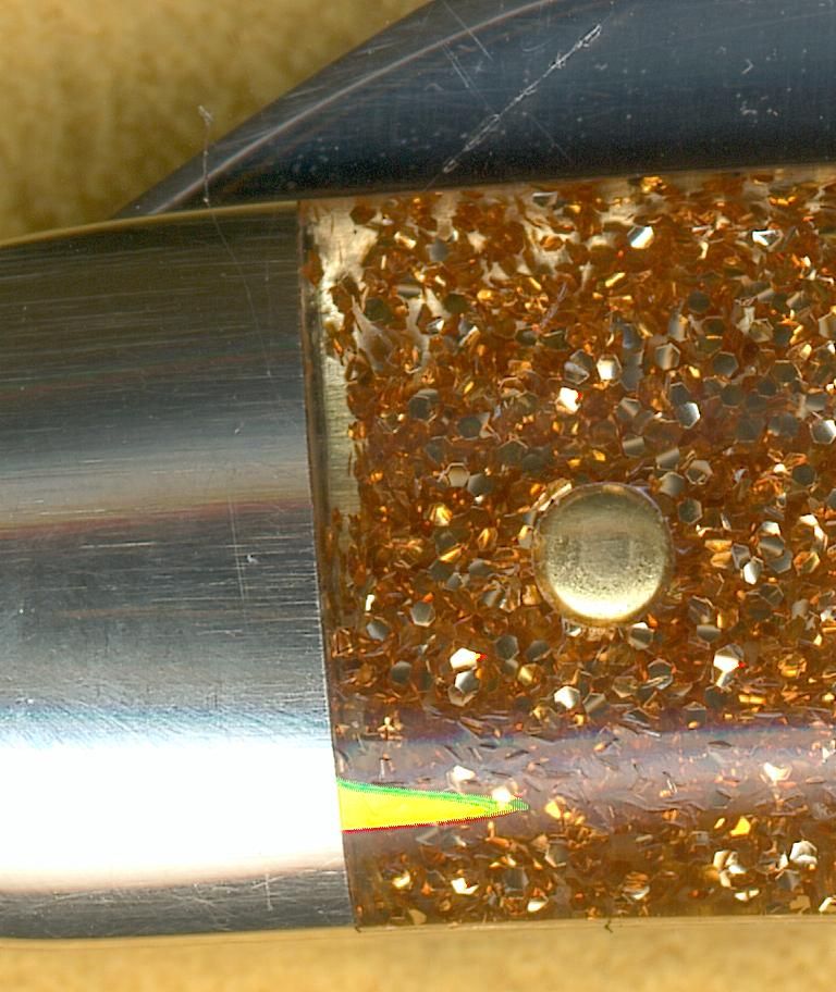

I have it on good authority the handles are made from the skin of a 1969 high output Ford Mustang that had an unfortunate mishap!:D
Nice choice of blades, and I like this pattern quite a bit.

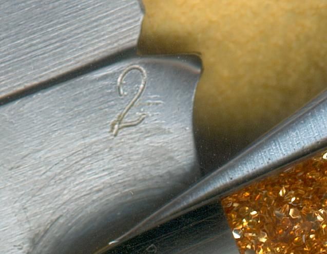

You will note that there is an elegant little "2" stamped above the kick on the spear blade:
This denotes a factory second. It seems the Mustang Hide was a bit moth-eaten, so it could not be put on the market to represent GECs finest. See close-up below.

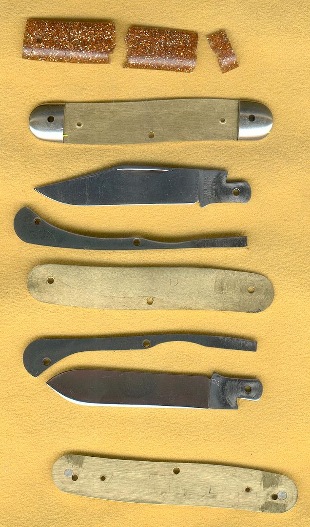

Look at those beautiful rivets! Observe the slight relieving of the spring, so it works smoothly.
I've wondered if the round part of the tang contacted the spring, along with the run-up, when the blade was open - the knifemaker's secrets revealed!!
What else do you see??

I am not ready to complete the DIP yet. I have been observing the halves of this knife, and it is like having one of those see-through demonstration pieces!
It is a delicate balance of fitting that makes these darn things work so nicely. If you look at this "closed" picture, you can see that the blade rests against the spring end, and stays nicely clear of the rear part of the spring. If it strikes the spring, it would, of course, dull itself instantly.
Two points on the blade touch the spring; the cam end of the tang, and the kick. I have filed the kick of an old, worn blade, to get the point down/back into the knife. Most of you know what I mean - sometimes an old blade wears to where the point becomes visible, and catches on everything.
Now I see why the spring "drops" when you do that. If you remove any material from the kick, it allows the spring to drop closer to the blade, as well as rotating the blade into the knife.
So in constructing a new knife, all these little points have to be dead on, or something won't fit right!
You gotta hand it to these guys. It's right up there with watchmaking and the like.
This knife, a mini-moose, (here's where Blues makes a comment or two :D) is like making two simple one-blade knives, side by side. The task gets more complicated when 3, 4 or 5 blades get specified!
The goin' gets tough!
