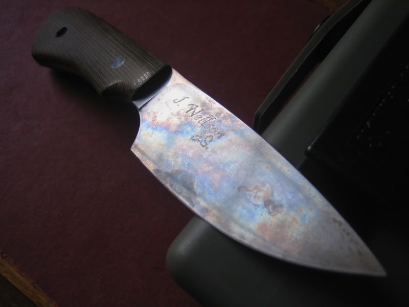

A "patina" (or patination) is the process of oxidation on steel or other metals.
Just as copper or bronze will turn green... the surface of carbon steel blade will oxidise when used to cut acidic foods.... some foods are more acidic than others.
Because the patina is only formed on the surface of the steel... it can actually help to prevent rust.
Here is my well used J Neilson knife custom made from 52100 steel (ball bearing steel)
I have used INFI on a lot of foods and it doesn't seem to patina like a carbon steel.
I have seen INFI's corrosion resistance compared to ATS-34 and that seems about right... although it's a completely different steel.
"patina can refer to any fading, darkening or other signs of age, which are felt to be natural and/or unavoidable."
Now that is pretty! Nothing like the look of a well used knife with a rich patina. Reminds me of all the old butcher knives and cleavers passed down in the family.
