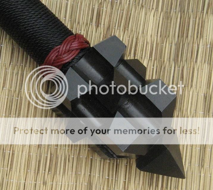

I just have to say, I am still amazed by the Scrapizashi and S7. You can't break one by bending it. I have a scizzy and stabbed it into a log and gave it a good bend one time and it sprang back like a bow. It blows my mind that something can be that hard and that flexible.
you mean like when you press the end cap, it stops time? that would almost justify the price
