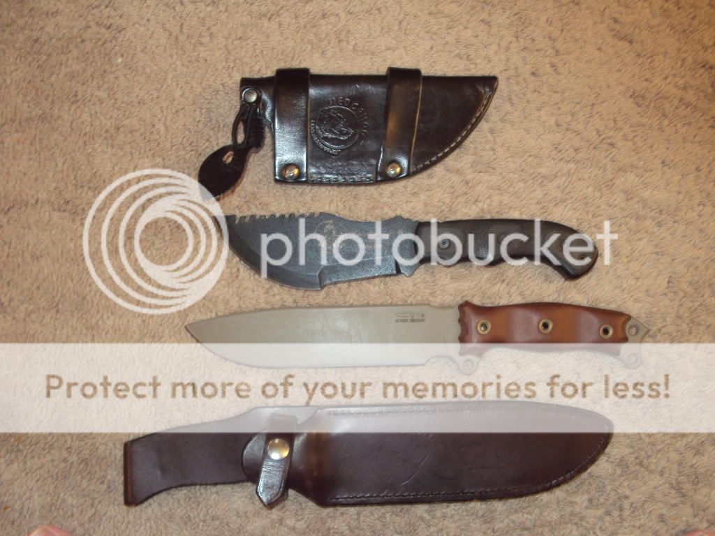

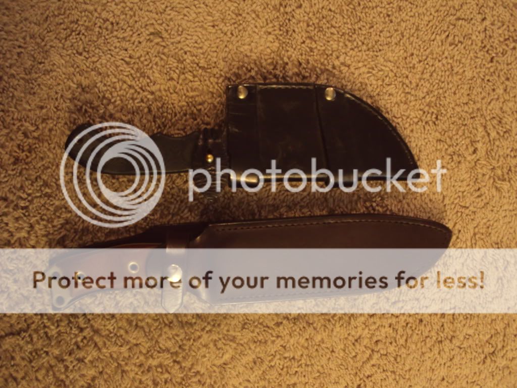

I have used my NMSFNO more than once. Busse knives take quite a bit of use before much wear will show.
Nice try at trick photography! :D :thumbup:
