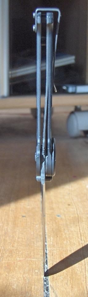

I think there was a guy a year or two ago that showed-off his and said that despite not engaging the secondary lock, the primary liner lock was solid enough (the secondary lock is a good thing though since I'm very picky with liner locks).

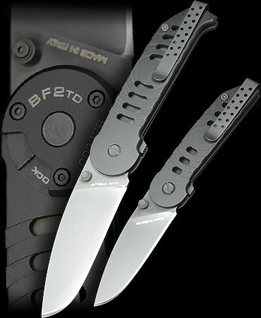

Here's an up close pic from Heinnie.com and a so so shot of the lock-up FWIW -
