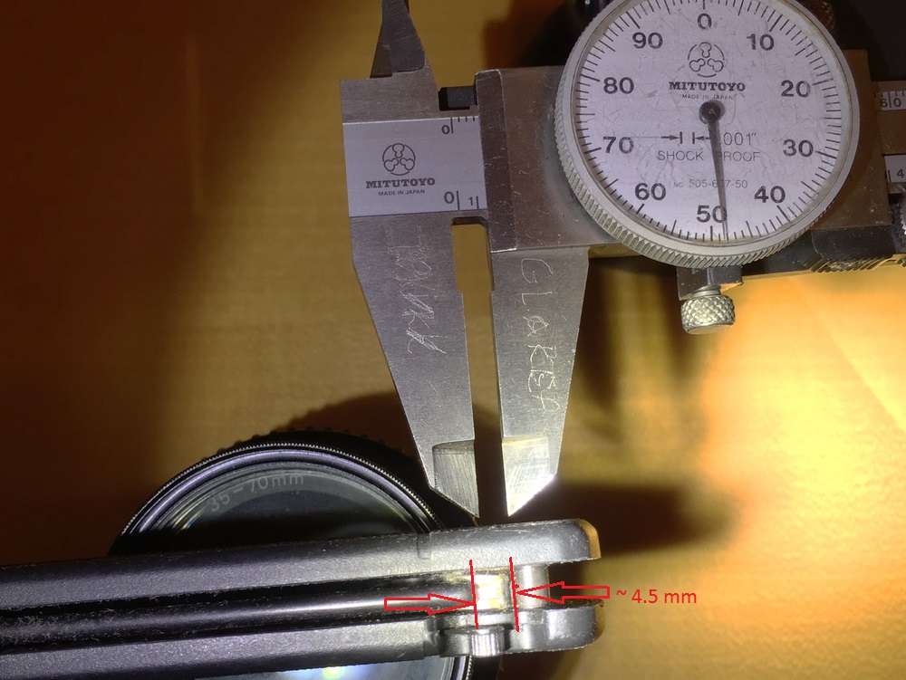

I apologize for the off topic but I see this complaint so often and it is true, they could think about this design flaw, but the fix is ridiculously simple man, here it is:
1. Loose the screw that holds the torsion bar and center it so it'll be in the middle of the blade/between the two liners.
2. Mark with something, whiteout, some permanent marker, anything you want, you can actually scratch the bottom of the torsion bar after you tight the screw little bit so it won't move and it'll give you a center line .
3. Remove the torsion bar and flatten/ grind it's surface where it's facing the screw to about 1/3 of the bar's thickness or less.
4. Remove the screw and flatten the part of it that is contacting the bar.
5. Install the bar and the screw together, use some blue Loctite on the screw, and push the bar inside so the distance between the end of the bar and the edge on the blade base are about 4.5mm apart, just as it is on the picture.
6. tight the screw as much as you can and you're done. As it's visible from the picture, my knife is full of lint and dust and works flawlessly.
Didn't touch it for years, just blowing it once in a while with the compressor and dropping some oil on the part of the blade that's rubbing on the torsion bar, that's it.
Something that should have been done in which ever factory this is made in and/or caught by CRKT before it ever went out. Sold that knife years ago man. Wish I had seen this before. And I did look hard! Apparently Williams prefers it unassisted himself. Knife was actually great without the torsion bar. Complete fail with it.
I understand, it happens. Mine was in the same way, the more I open and close it, the more the torsion was rubbing in the liner...
I got pissed one day, opened it up and figured out what was the problem... I completely agree that they should think about this, it's not a rocket science and it's very easily executable during manufacturing I believe.
It is just me, but with knife like this I would like to leave the opening as much as I can to the mechanical factor... :D Torsion bar is quicker than my thumb, doesn't get tired, and it needs minimal push to start working, something that I would not guarantee that will be able to execute better if needed.
