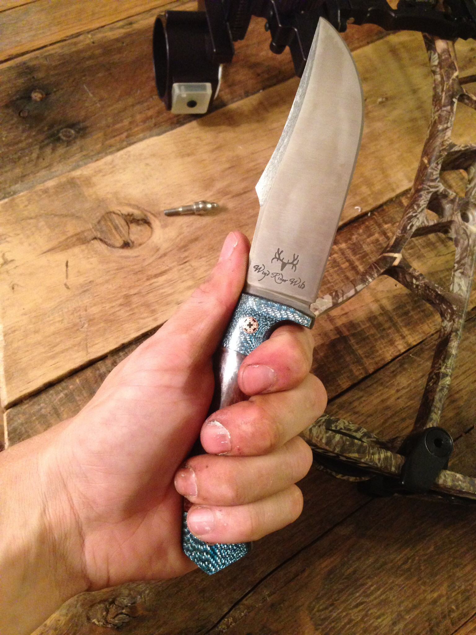

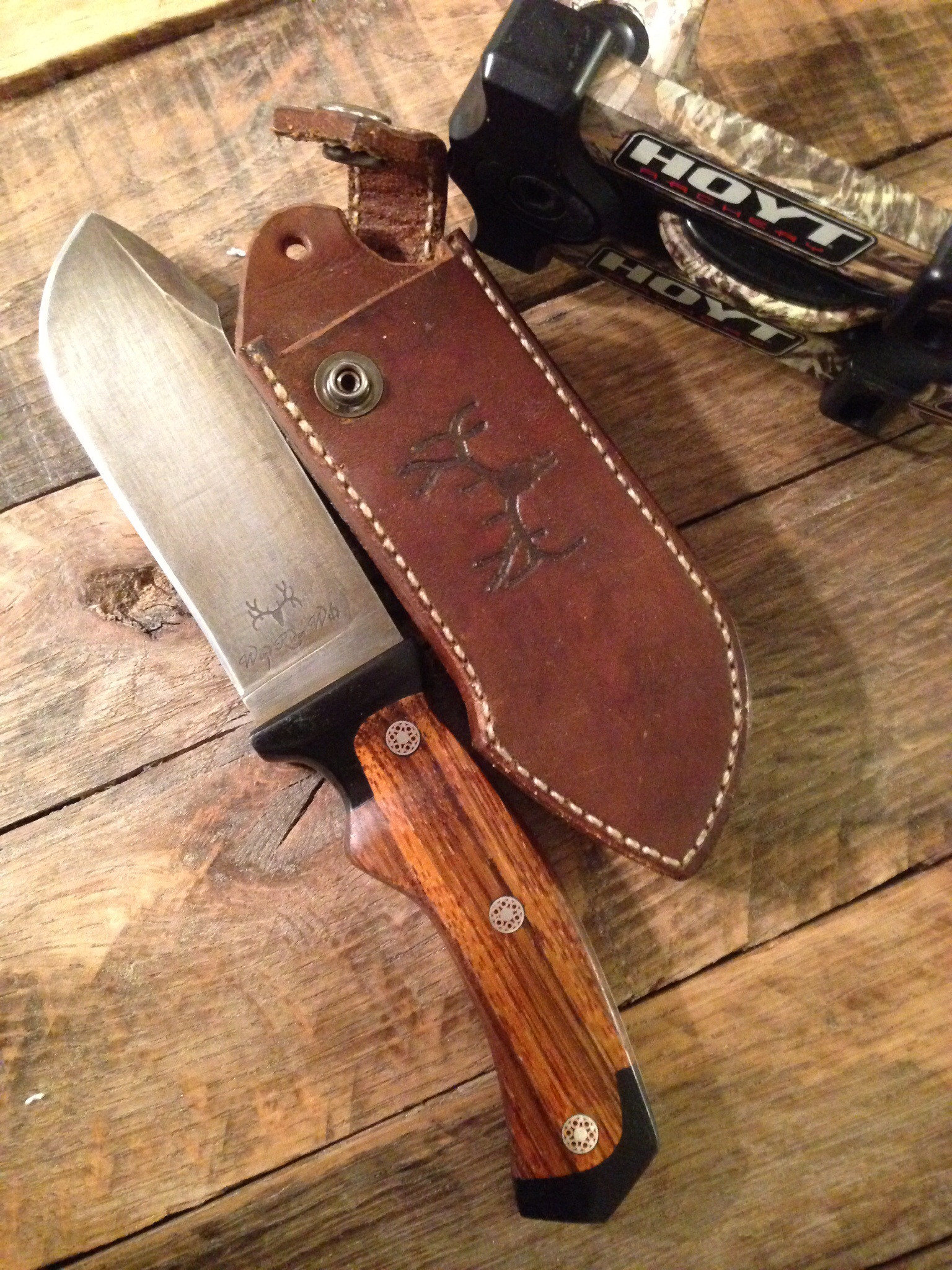

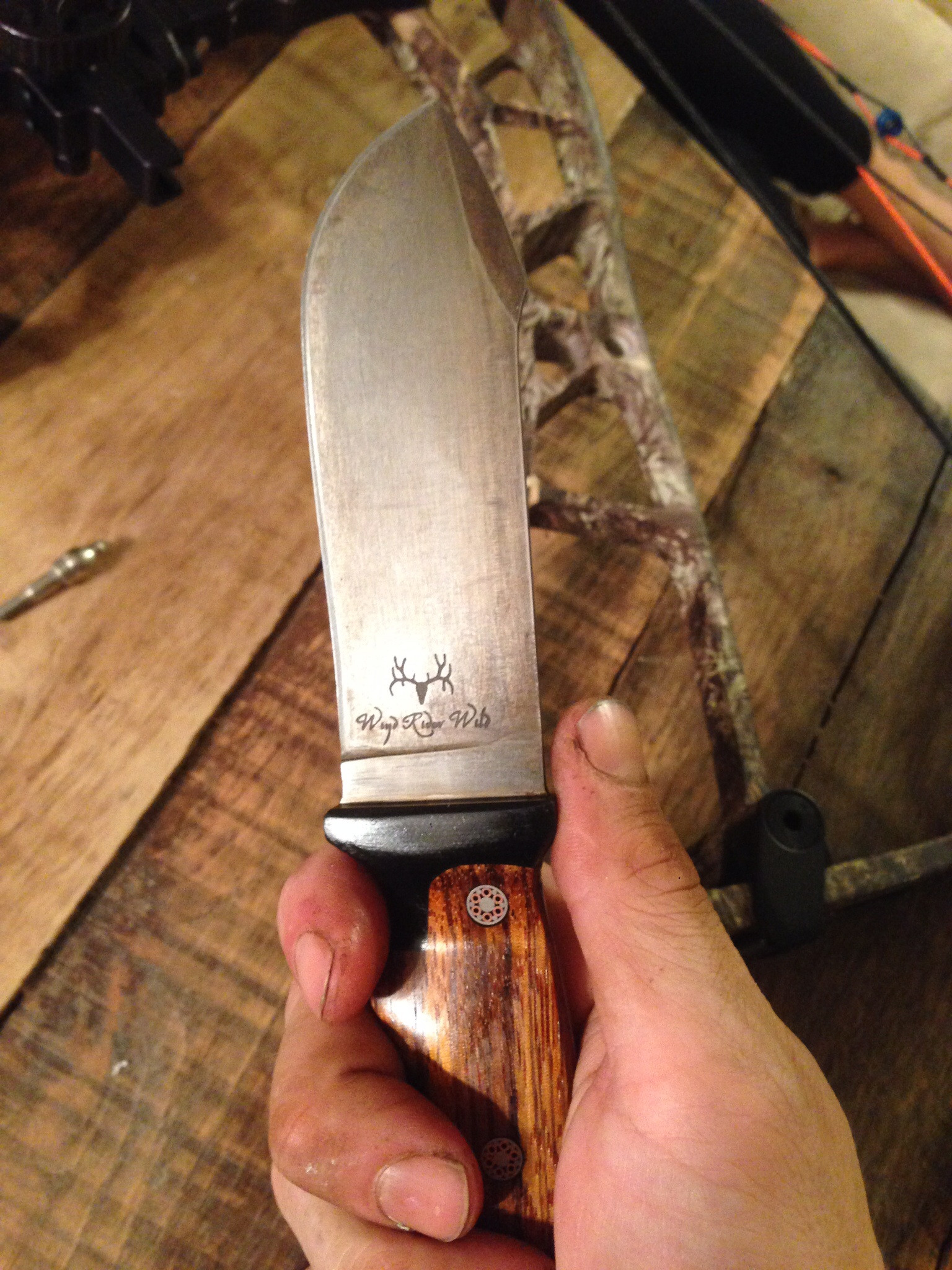

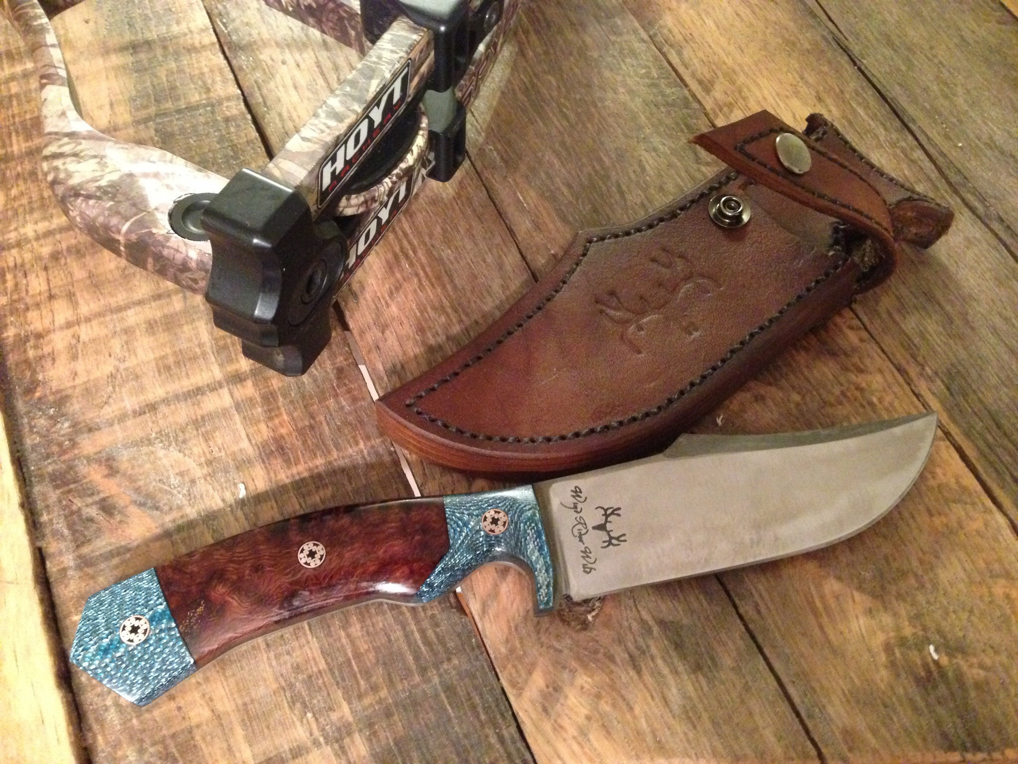

Just wanted to see if you guys had any suggestions or opinions for me on these first couple of knives I made. This is my second and third finished knives. The first one looked kind of like a steak knife, and then I just totally ruined like three of them. Anyways, they are d2 steel at 61 rc (by peters) one has an acid /patina finish with zebra wood and g10 handle, and the other one is satin finished to 400 grit with stabilized walnut burl and carbon fiber handles. You guys make the coolest stuff so I just wanted your opinions on what I could improve on/keep the same, as I am debating buying a knife makers membership. Thanks guys! Oh, and let me know if I posted this wrong or something

Really good job. I also like the first one. The handle materials really compliment each other. However, the bump behind the finger notch looks too big. Like it could creat a hot spot with a lot of use. The handle also looks too boxy. Try and round the handle a bit more. My first knives also had these boxy handles.
On the second one, the spine is too straight and the belly is too big. Because the spine and edge are parallel until near the tip of the knife, it makes it look like a bar of steel.

I think it took you quite some time and attention to detail to fit up those handles. They are unique and I especially like the first one. If you are considering a Knifemaker membership so you can sell your knives, I think you will need get more detailed in your blade finishing. There are quite a few visible scratches and inconsistent scratch pattern in the finish. If you are going to put the kind of time in to make those interesting handles then you are going to want to get paid for it and you won't if the rest of the knife is not up to par.

The knives look good for you second and third! It may just be me, but you makers mark is hard to read. I really can't tell what it says.

Good work so far...keep at it. The critiques below are design comments for future knives, these appear well made.
On #1:
The overall shape is nice, but maybe you have too many curves and angles mixed together. If the curve from butt to clip back was even, I think it would have a lot more "WOW" factor. The dip into and out of the ricasso spine area distracts the eye.
The handle looks nice, but thing sections and points will snap off easily in use. CF is tough, so it isn't quite as much a risk, but avoid long thin pieces of handle material like you have on the lower guard projection.
The front mosaic river wasn't quite clocked straight. Make sure all mosaic rivets are aligned the same, or the one not aligned will stick out like a sore thumb.
#2
The blade is strangely shaped. It is too fat and "blunt" looking ( sort of looks like a garden tool).
While a harpoon clip looks good on some knives, it isn't right for every knife. On that blade it looks like a hindrance, not an asset.
I would loose the thumb dip on the spine to make it more "flowing". The two-tone handle doesn't seem to work here. ( it is really well done, just not "fitting in" with the rest of the knife.). Maybe all black G-10 would have looked more like a user.
Probably just me, but the logo looks like it is on upside down. I would place the handle at the top of the logo, not the bottom. Certainly more aesthetics than a real issue.
Also think these are great for such early knives, especially the level of joinery that went into the handles.

love the handle material on the first knife, great looking knife, I feel like the mosaic pins should have been rotated clockwise to line up better with the top of the handle, to increase the flow of the arc
second knife, great handle, but the blade is a little too chunky, kinda like my first wife ;0)
Both knives are pretty good, the first one in the pics looks better to me, I agree with Ranger Bob's comments, I think your first knife (second one pictured) would look better if you had a different finish on the flats and the swedge of the harpoon, sort of like the first one--the swedge on the harpoon looks like it has a different finish--I hate mosaic pins for a lot of reasons, but you MUST line them up IMO if you're gonna use 'em. Your sheath work looks very good--you're stitching appears impeccable--nice blades to just get going with!
Guys, you are amazing as usual. I totally agree with what you said. Some of the stuff I saw and was planning to change and some of the stuff I never would have thought of in a million years! Lining up the mosaic pins? Great idea. I agree with the finish suggestions wholeheartedly, I was just having a hard time getting that last little bit out. I also agree that that second knife looks like a garden tool. Haha. I think my next one will turn out a lot better with your suggestions! Thanks a ton for the help!
Not much to add other than whats said as far as critiques. For lining up the mosaics leave a bit sticking out and use a hacksaw blade to cut a slot in them. You can easier reference the "north/south" for lining them up and you can also use a screwdriver to rotate them to line them up. But overall very good work.
