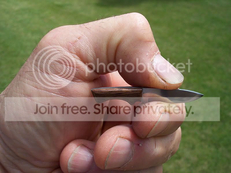

It’s FUN to make miniatures! Costs are negligible and comparatively quick to complete, especially if you are using files to make your knives.
This is my “Barbie” knife, full tang, made of 1095 steel, 2” OAL, heat treated and sporting a walnut handle.
