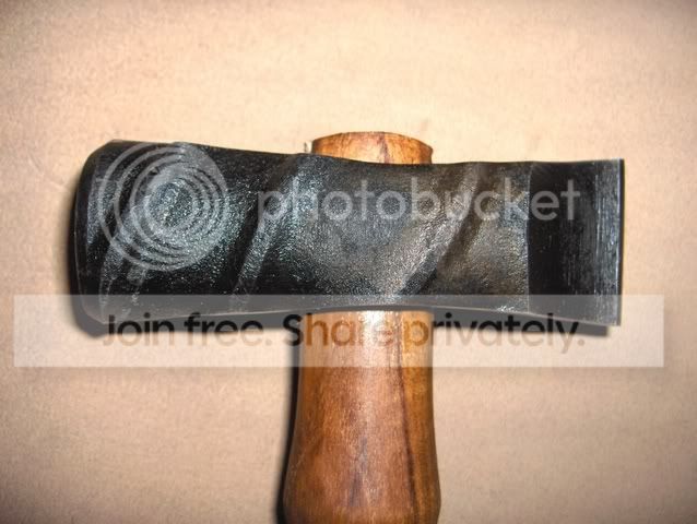

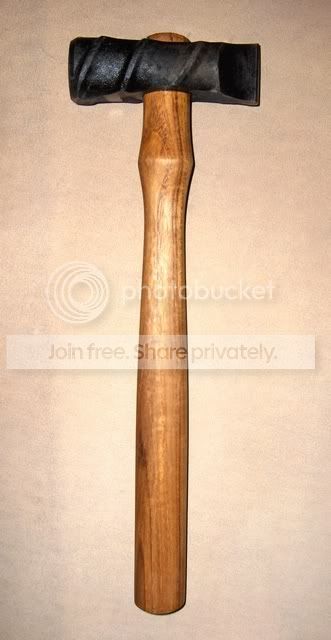

Rebar can have .44-.52 C and heat treats great.
I forged a 2 Lbs hammer from a chunk of #14 rebar a few weeks ago.

I bet someone could go and search the archives and find more than one post on rebar knives....Ray has made rebar knives for years,I have made a few and I have also made a tomahawk out of it.If you use the 60 grade it will hold a great edge when heat treated properly...Rebar makes a great mix with a different steel for Damascus also.Hammer heads are great from the proper rebar....

Bruce, can you explain what you mean by the proper rebar for hammers???
