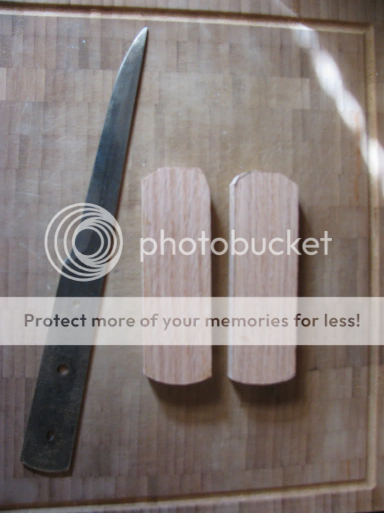

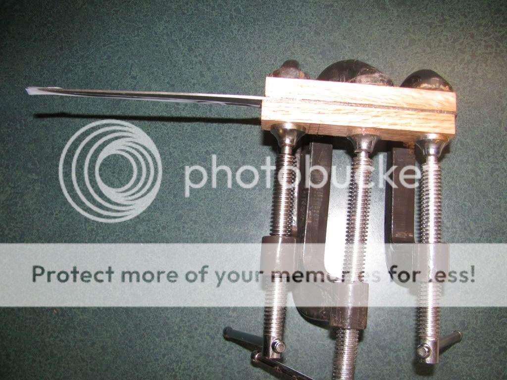

Scales cut to size and epoxied. Given the overall coldness here and that I used slow epoxy, I'll probably give these a few days to get nice and hard. I'll have some pics / updates next week.
I have exactly 0 experience in this area and am trying a hidden pin construction. All hand tools. I typically learn by making a mess of things, so we'll see how this goes.
Getting started:
Clamped up, epoxy getting to work:
Little rasping, little filing, little 80grit sanding we're getting there:
Still got some work to do, but getting there. These will be thicker than the originals.

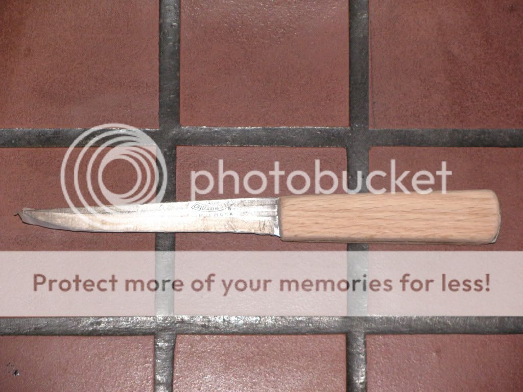

I have 4 Old Hickory knives & love em. 6" boneing, skinner, 7" butcher & the cleaver. Don't chop bone with the cleaver, it will deform the blade. I pounded it back & got lucky.

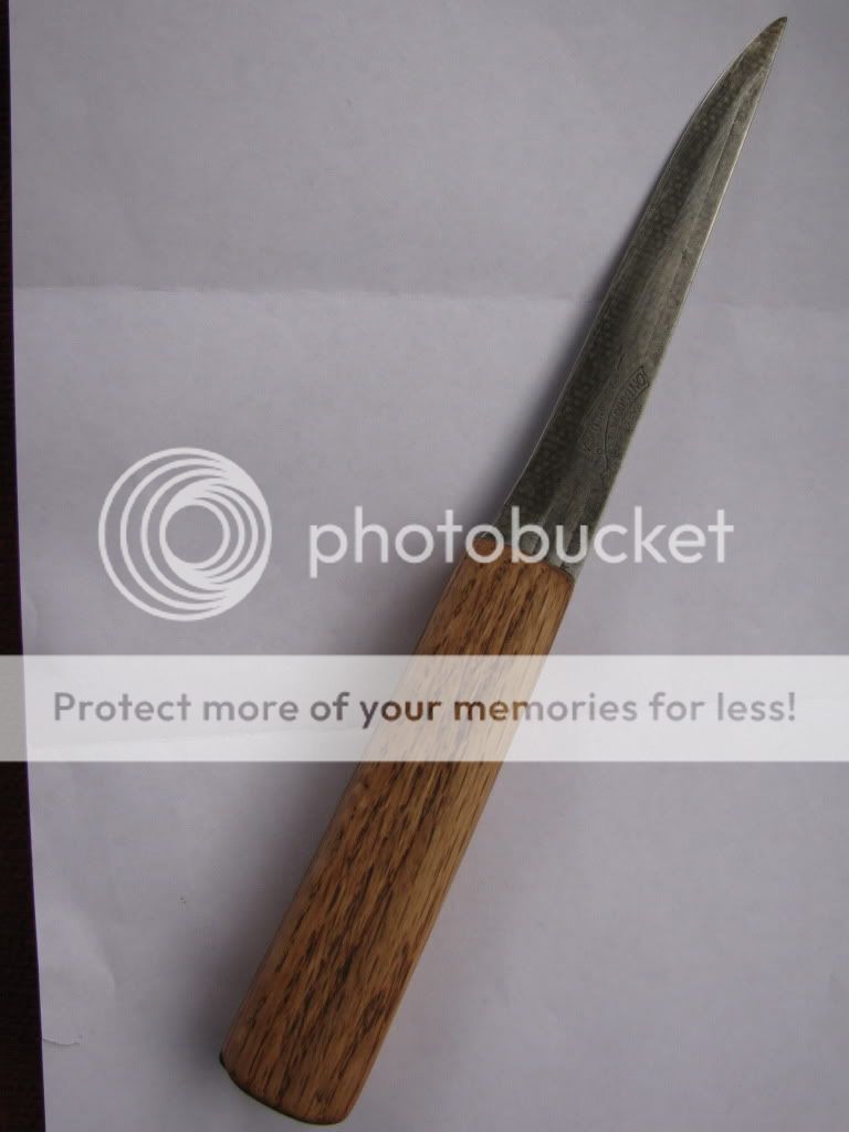

OK here we go- The above pictured Ontario with it's new handle.
I'll post a more complete account later. I still have to fine tune it.

Not very hard, just alot of patience. Besides hand tools, I used a table sander & a dremel. Some rivets were fitted to keep everything nice and tight if the glue doesn't do it's job.
Handle strikes me as a cross between the aforementioned Tops, a Collins Raider bowie, & a machete.
Like I said, I might tweak it a bit. Shape it a little more to my hand and add a brass lanyard hole liner.
Hope this helps somebody out.
