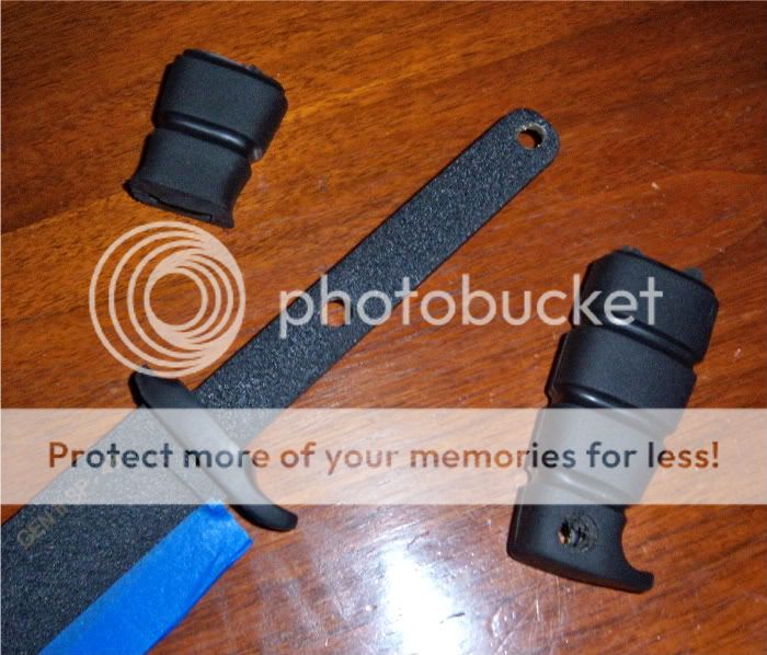

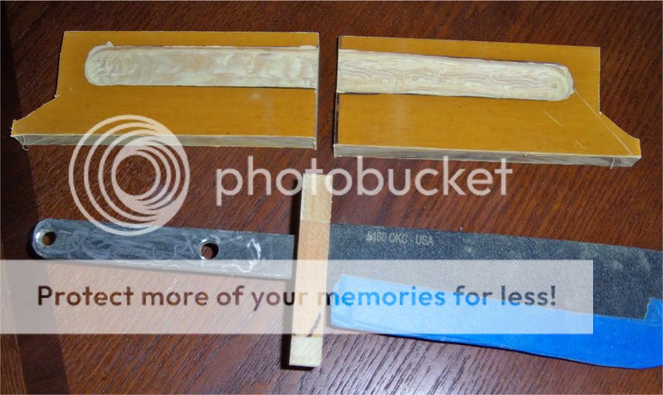

Knife with handle cut off, exacto knife handled this.

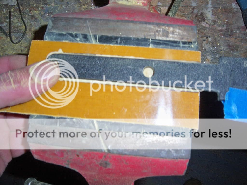

I had scrap micarta laying around, for this size handle I used 3 pieces. 1 for a guard & 1 on each side. Knife is going to be a beater anyway.

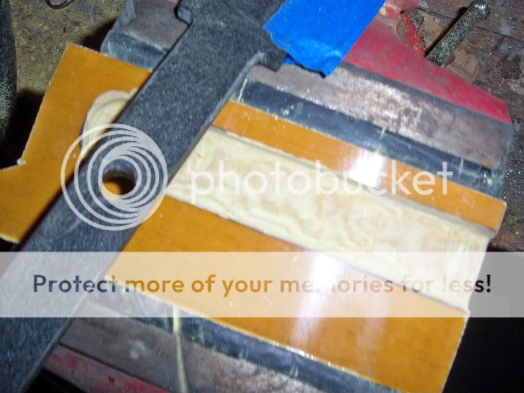

I drilled out the guard piece and filed to fit, then inletted each slab with a dremel.

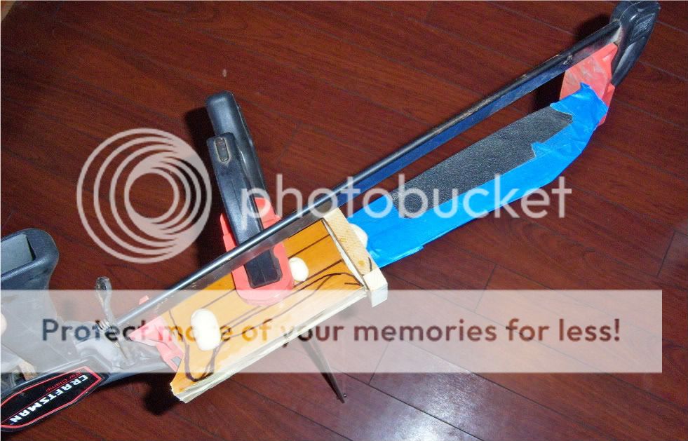

After dry fitting everything, some gorilla glue and clamps handled the assembly.
I did roughen up the sides & tang to be glued, and drilled pin holes to match the tang on one slab.

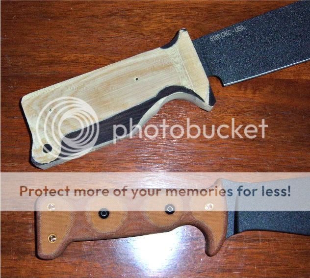

Note rough outline of shape I was thinking about. Decided to pattern it after my Power Eagle.

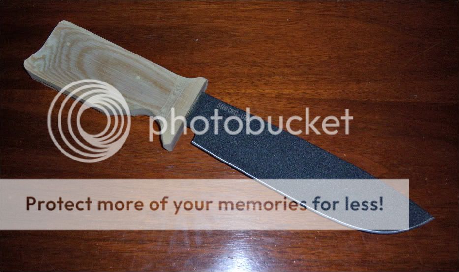

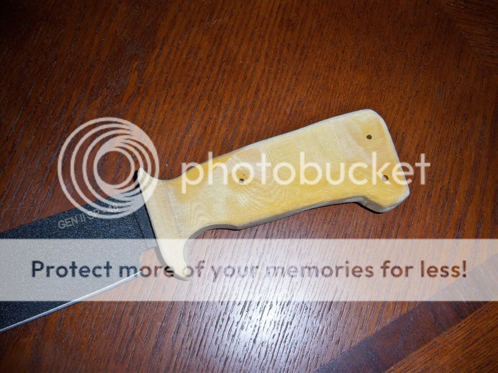

Rough sanded to shape.
Not very hard, just alot of patience. Besides hand tools, I used a table sander & a dremel. Some rivets were fitted to keep everything nice and tight if the glue doesn't do it's job.
Handle strikes me as a cross between the aforementioned Tops, a Collins Raider bowie, & a machete.
Like I said, I might tweak it a bit. Shape it a little more to my hand and add a brass lanyard hole liner.
