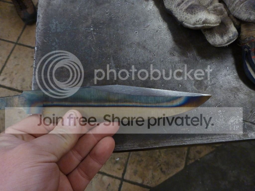

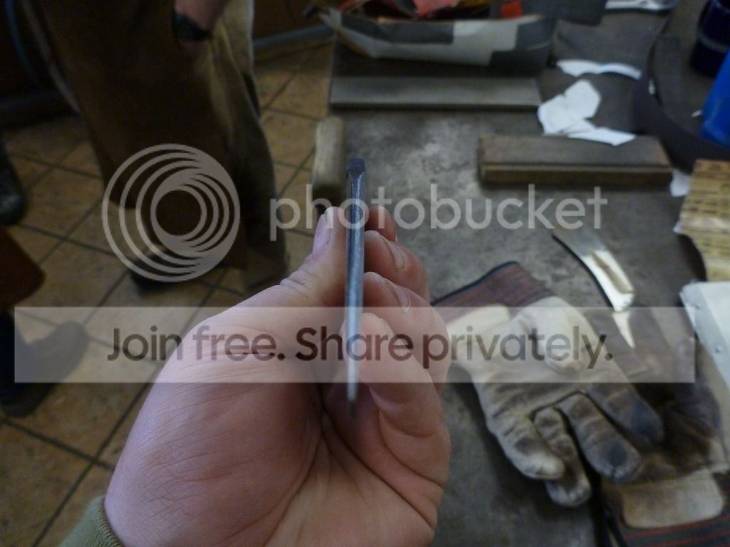

The video is currently uploading, but here are a few pictures of the knife he ground to tie everyone over ;)

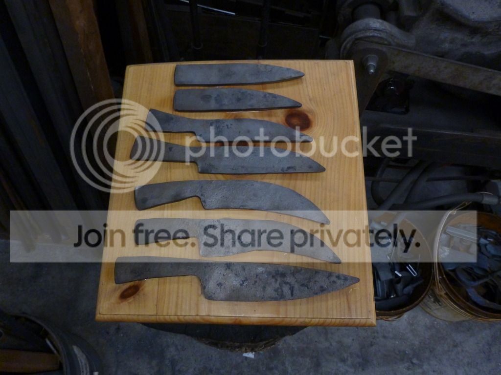

This was also a day where we were asking any relevant questions we could think of in order to pick the brain of a master smith before we went home! I had questions about forging a kitchen knife, which Jim deferred to Nick who had more experience. I was able to watch Nick give guidance to another student as he had asked about the kitchen knife forging process before I. At some point, enough folks asked that we were treated to the process from start to finish by Nick.
Here is the sample board, with the different steps that Nick Demonstrates.

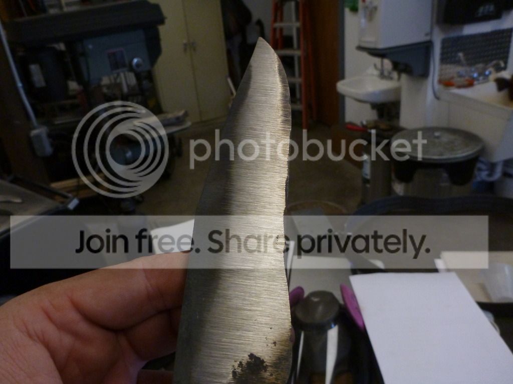

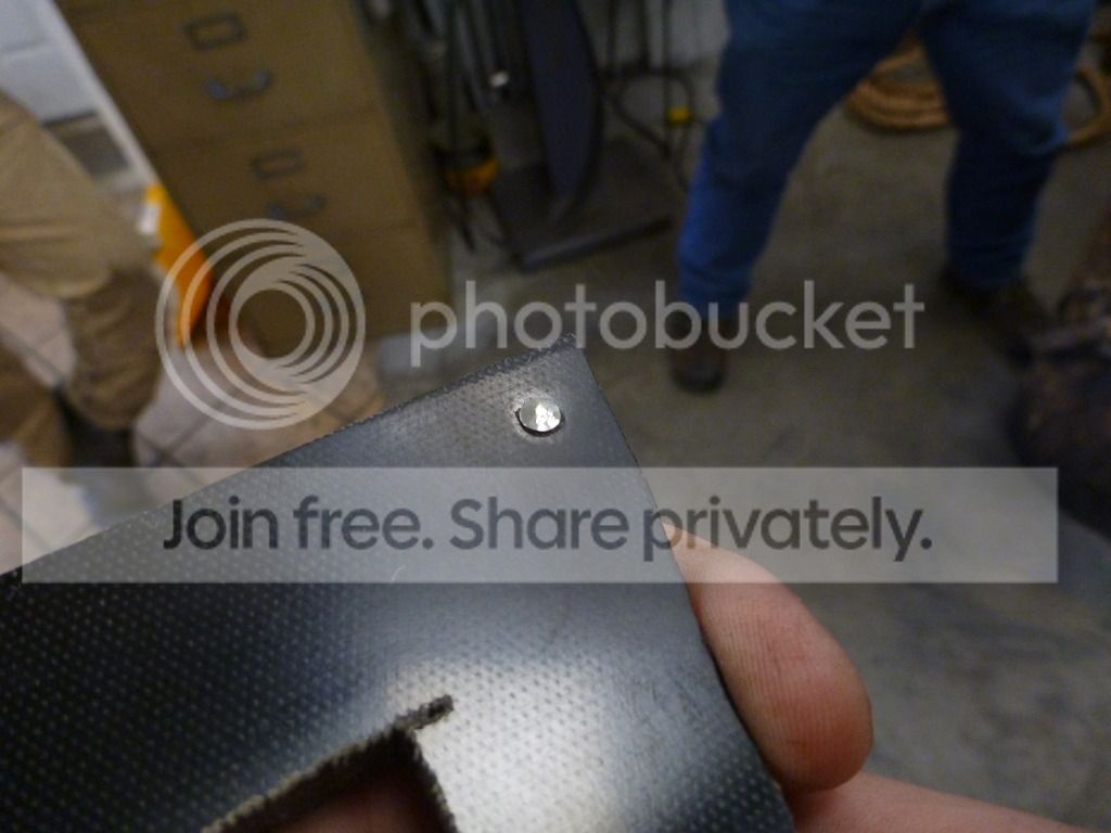

After the kitchen knife demo, I asked Jim how he peens a pin. I figured it couldn't hurt to watch him do it! I thought I had a video of it, but it turns out a bump from folks around me made me hit the button, so it stopped part way through and is kind of useless, but here is a picture of the pin after he had worked it for a minute. He uses a 1 pound ballpein hammer and said to just NOT hit anything but the pin. LOL, really simple right?

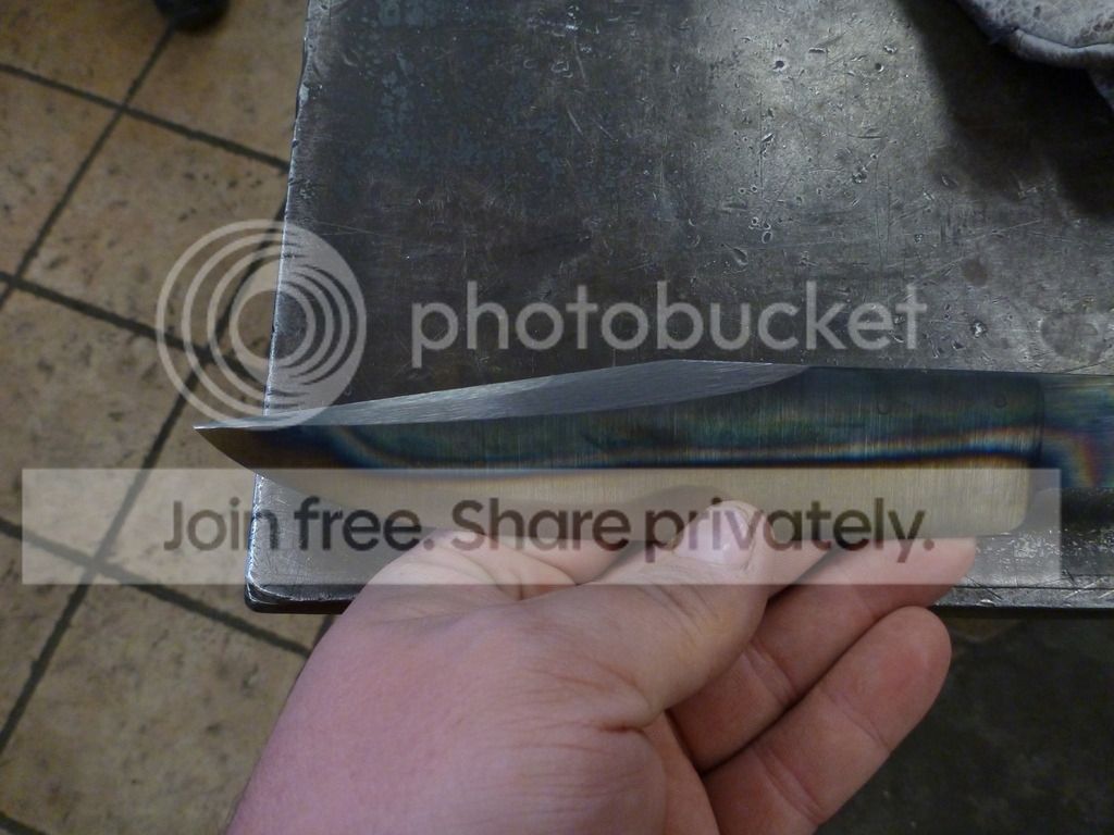

There were quite a few demonstrations of how Jim heat treats his knives in order to get that awesome temper line going through them. I admit, I had him do it to my 'project' blade which was definitely inspired by the bowie he brought with him at the start of the class. This is NOT my knife he is treating, but the principle is the same. Maybe I'll upload mine since I have a different view, and it is also closer since some folks had decided to leave the are after seeing him treat 3 knives before mine. This is definitely NOT as easy as you'd think even for a few folks who had used torches quite a lot. For me who'd never handled one...it was about impossible!
[video=youtube;v1xOiCUf6zw]https://www.youtube.com/watch?v=v1xOiCUf6zw[/video]
Here is my project knife, sanded to only 120 grit and not completely at that...but if you can look along the length of it in spots you can see the temper line! (quick note, if you look at the group shot of all the knives I created in this class down below, you can see in the 2nd knife from the top, the line is a bit more evenly shown in that light and angle)

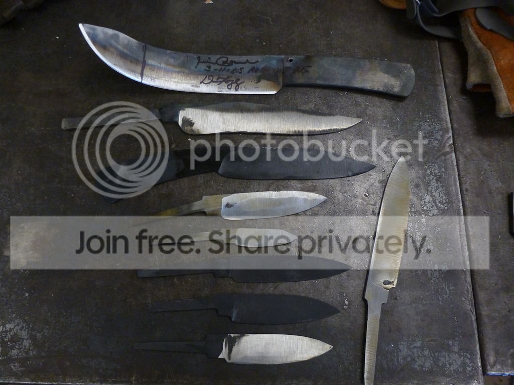

These are all the knives I made during the class (the one missing is the test knife which broke)
