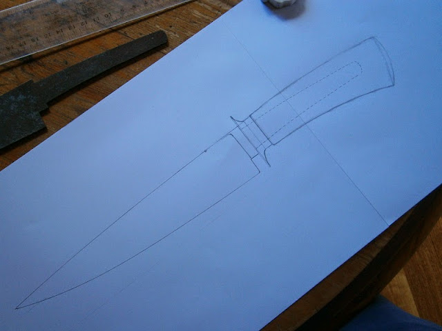

This is the design I decided on. I try to work from the drawing as much as possible. I also made a mild steel pattern to work from.
These are the materials I used. O1 tool steel (5mm thick), 304 stainless pinstock (3mm dia), 304 flat bar (6mm thick), the two smaller pins (2mm dia) are stainless, but I'm not sure on the grade, and not pictured is a chunk of Tasmanian Blackwood.
Here is the pattern I mentioned earlier, clamped to the O1.

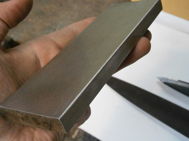

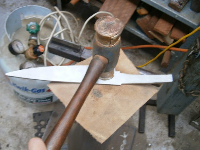

The flat ground O1 is never quite flat, but that is easily fixed.
I cover my ‘anvil’ with a piece of leather and gently whomp the warp from the steel. I go back and forth from the surface plate to the anvil until I’m satisfied that it’s flat.

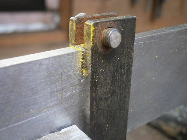

I set my work rest perpendicular to the platen.

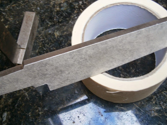

At this point I find it pays to cover the flats with some masking tape. This helps protect the blade from being gouged too badly by the grit on the work rest.

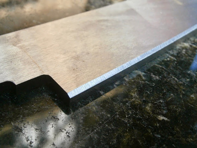

Roughing in the ricasso width with a worn 60 grit belt. The belt tends to drift on this grinder (Coote) if any force is applied to the edge, so it can be very difficult to get right into the corner. I remove the 60 grit scratches with a 400 grit trizact belt.
As you can see here, what I’m left with is almost a radius. This area will later be refined into an actual radius .

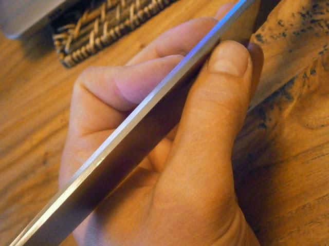

I start with a small, steep bevel on either side
Gradually I walk the bevels up towards the spine.
Here you can see I’ve knocked off the top of the bevel. From this point I start flat grinding.

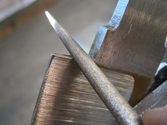

Using diamond files, I deburr all edges that need it. And radius any internal corners.

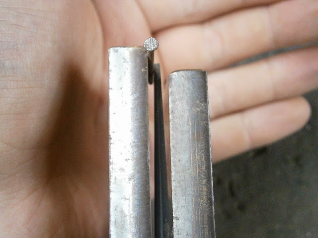

After quenching I wipe the blade down, and clamp it in between these flat steel bars. Then the whole lot is put into the tempering oven.
My tempering oven is just an old domestic oven that I've gutted and rewired. It now runs off a PID controller.
After 2 hours I take the blade out and check for warp. If there is any (and there was some) I clamp it back up and add shims (a nail in this case) wherever I think they’re needed, then put it back in the oven for another 2 hours. I learned of this method from a thread by Rick Marchand, and have used it many times. Cheers Rick!

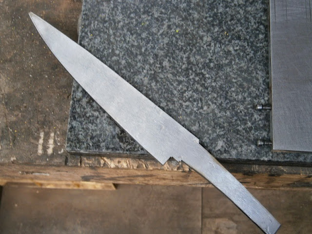

The tang still has a slight bend to it, so I hang it over the edge of the surface plate while I scribe a new reference line.

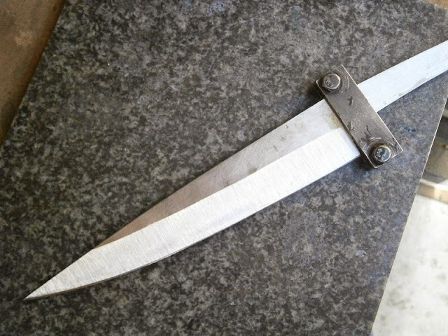

Now the plunges can be evened up a bit.
I clamp a guide on, just in case.
And this is the result. not perfect yet.

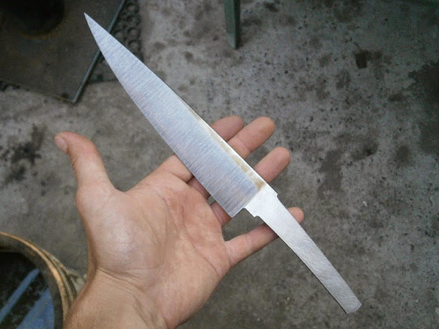

Now the bevels get ground to full height, still using a 60 grit belt.
Then I get rid of the 60 grit scratches and replace them with 120 grit scratches.

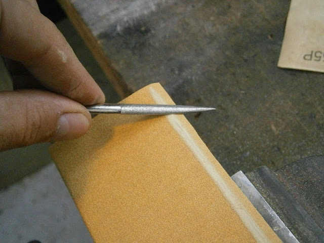

I use a stainless steel block with a radiused edge.
Sandpaper is stuck to the steel with some spray adhesive. I used 120 grit.

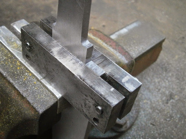

I clamp on a small file guide to avoid rounding off features when I inevitably slip.
This probably doesn't make a big difference, but I use a diamond file to strip as much grit from the other edge of the block, to avoid cutting a groove where I don't want one.

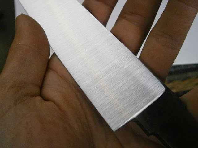

Then the plunge in worked against the radiused edge of the block until I have even and nicely radiused plunges.
Here is the result:

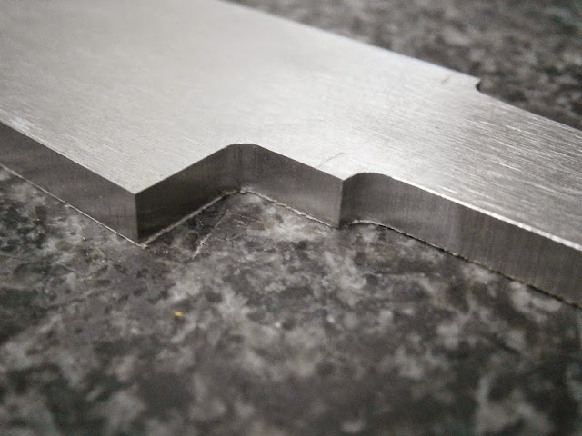

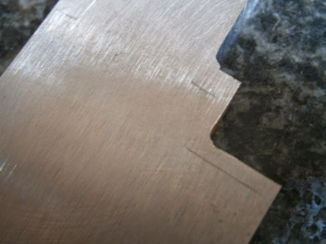

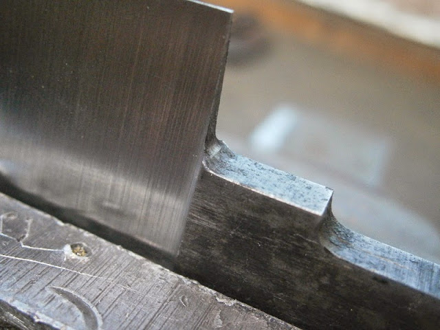

The next thing I do is refine this area. I want a nice tight radius in that corner.

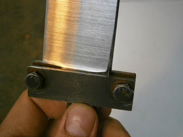

A piece of micarta is clamped to the ricasso/tang. This piece should be pretty square.
Then using the plunge finishing block, I cut in the radius and clean up the other surfaces. For this I used 320 grit paper. The micarta piece stops the blade from rocking.
Not a bad little radius, and the 320 grit scratches will take very little effort to remove.

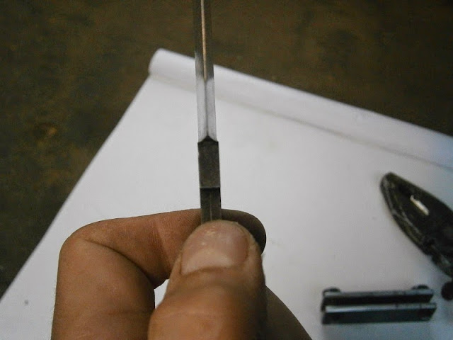

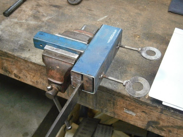

Now I give the spine some attention. The blade is clamped spine up in my version of a knife maker's vice.
I use a small diamond file to remove the bulk of the material, and true up the lines.
Then I refine the finish with a diamond stone/hone thing.

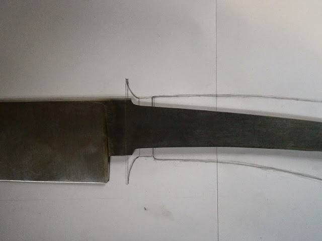

I mark out where the guard will eventually sit, just to help me visualise things a bit.
Working off the drawing, I mark where I need to drill.
