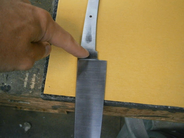

Time to clean up the ricasso.
I glue some sandpaper to one of my flat marble slabs, using some spray adhesive. I like this stuff.
Then I move the ricasso against the abrasive in an X shaped path, always trying to keep the pressure as even as possible.
Here is the resultant scratch pattern.
Then I go back to the disk and lightly grind the taper back up to where it was. I go back and forth in this manner from the disk to the flat plate until I have the two different scratch patterns overlapping where I want them.
