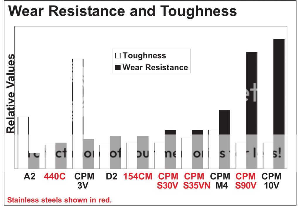

Crucible Steels for Knifemaking (June 2010): http://www.crucible.com/PDFs/Knifemaker REV June 2010.pdf
154 CM®/CPM® 154
154 CM is a high molybdenum modification of 440C offering improved wear resistance (edge retention) and better corrosion resistance. It is also available in a CPM version for improved toughness and polishability.

Mastiff and RamZar , thanks for the info.
This is why I like this forum so much. Every time I log in I learn so much about the hobby which I love. I had no idea that Carpenter owned Crucible. I thought that they were bitter rivals. I can see I still have much to learn. And that steel chart is great. Thanks.
