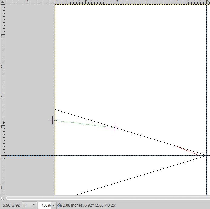

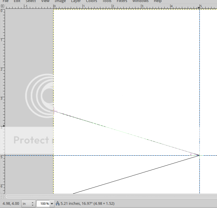

Okay well since it's time for visual aids... Mind the ruler above the drawing. Resolution is 100 pixels per inch, the cross hair is centered at 5" on each axis
Start with any degree angle, in this case 34 inclusive ( 17 dps )

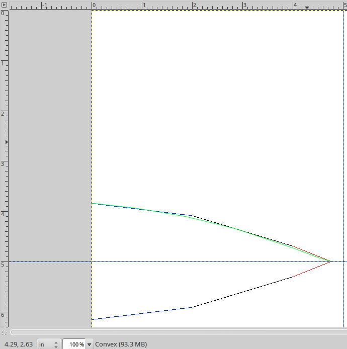

Now grind in a more acute angle, until the new bevel goes half-way down the old bevel, like shown here. 5-10 degrees is best, here we're doing 7 degrees per side (would probably be about flat on the blade for most knives)
Now grind in a bit of a more obtuse angle. Let's just add 5 degrees to the original angle, just to really demonstrate. So that will end up with 22 degrees per side. As shown in this picture, you grind this bevel in until it travels up about 1/4" of the way up--remember approximation.

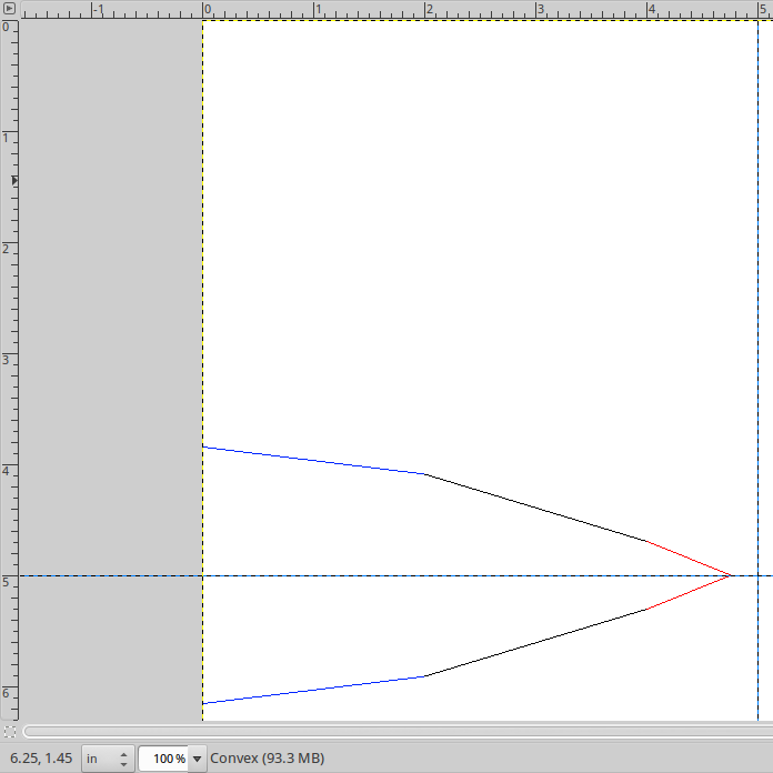

Now this is what you end up with, a compound V bevel...
Blend it together as described...

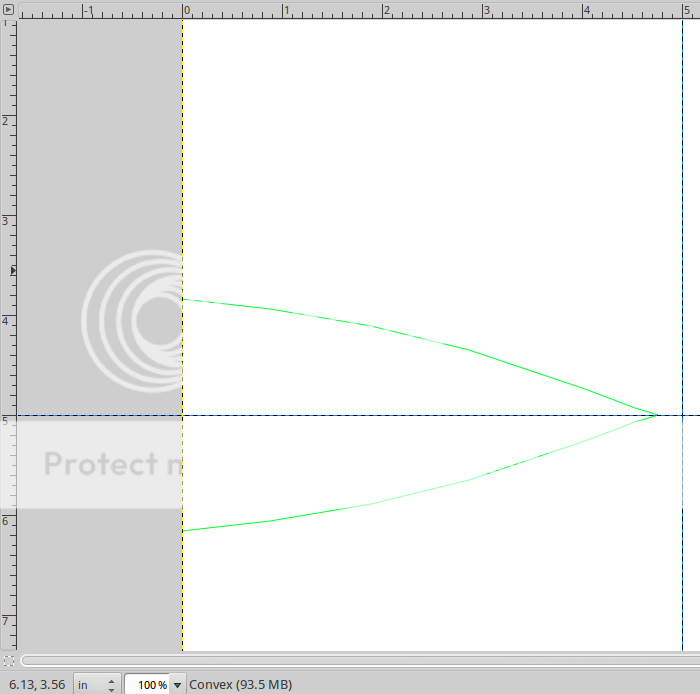

After blending it all together, this will be the new shape.
End result...

What you don't show in your drawings is that you have greatly increased the edge height in your conversion to a modified convex edge. You have also made the near-apex angle less acute.
When you raise the edge height, you will make the overall edge profile more acute, whether you are converting from a V edge to a convex edge or simply raising the edge height on the existing V edge.
Nothing involved in the conversion to the modified convex edge improves the edge profile, only raising the edge height. I can draw a V edge inside your modified convex edge and increase the acuteness of the profile. Unless you control for edge height and edge width, you cannot compare the relative advantages of convex edges to V edges.
And if you notice, as you raise the edge height, the differences between V edge and a convex edge become increasingly less significant.
