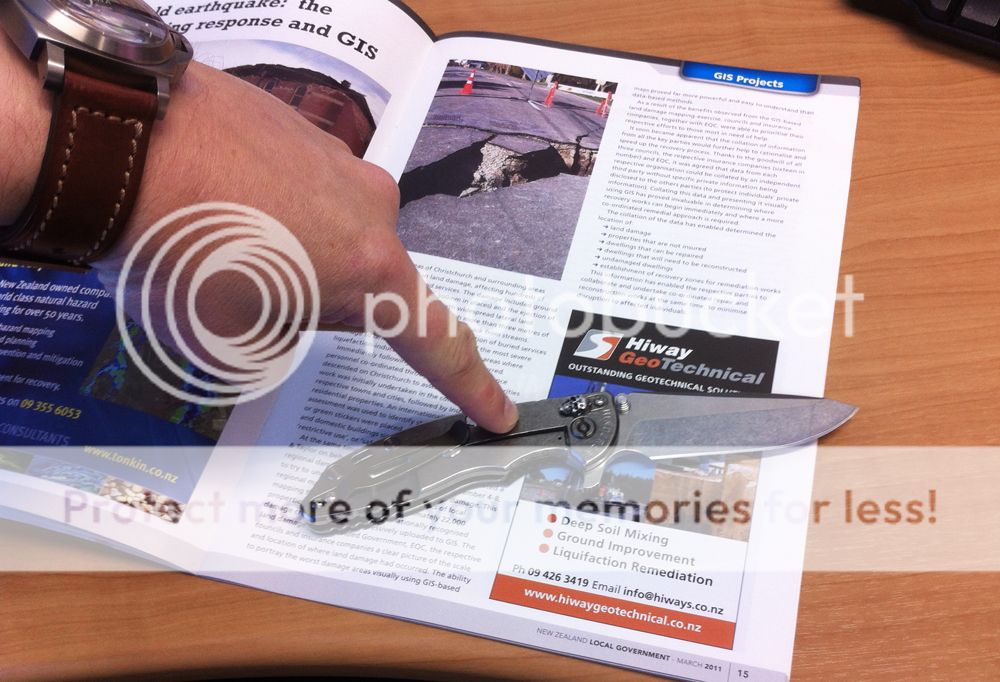

I just took mine apart, and there is no sloppy machine marks in the spring cutout at all.
There is a cut into the lockbar cutout towards the pivot, and I have no idea what it's for.
But it's not the same thing as the machine marks on the spring cutout on the Xm.
So why is this sloppy? I'm looking through pictures and scanning videos, and they are all the same way, in line with the longest length cutout for the lockbar facing the pivot. The Xm's go 2 different ways.
It's blatantly clear.
Hahahahahaha, I am not mad at all. In fact I was just laughing and having a good time. It is funny that you are willing to call Hinderers "sloppy" when CRK's aren't perfect either.
Seriously though... take yours apart and see. Or do I need to take apart all of mine and post pictures?

I maintain that it's not machined as well as the CRK. I openly acknowledge the cutouts on the inside of the Sebenza. I see them clearly here, I only have 2 small and 2 large, so I don't have a large enough sample to compare as I do the Xms.
But they are all going the same way, and there is 1 cut per lockside. The Xm has 2 and they go different ways. The Xm has machine marks in the latest spring cutout, the Sebbys all look fine.
The sloppy part is the machine marks in the spring cutout, visible on the outside of the knife. This doesn't exist on a Sebby.
The part that I am calling sloppy is the lockbar has inconsistent machining. Some have large indents, some have small, some go one way, another knife has it going another. They are not consistent. So which way will mine be when I get it? It's not just the simple existence of them, it's their inconsistency.

I don't think anyone is arguing about what purpose the holes serve.
Really? Your post No.5 highlighting those holes as sloppy machining evidence.
My point was the machining marks around the spring cutout are sloppy machining, thus CRK has machined their product to a higher standard... .
In your opinion.
And that the grade 5 titanium is a relatively brittle alloy making it unsuitable for prying, thus attempting to control fractures in 1 the front of the lockbar cutout is inconsistent with it's practical use and 2 the spring cutout reaches to back of the cutout for the lockbar so if you were to pry with it, it would naturally sheer at that point as the material is much thinner there, making it unnecessary to control the fracture at that point.
Makes no sense?!? A brittle metal is generally more prone to fatigue failure, therefore the need to reduce stress concentration zones increases. The frame is not designed for prying, I’m just confused as to why you mention this.
Sheer forces? How on earth did you get to that conclusion? The forces at play here would lead to plastic deformation of the lock bar – That is why Rick designed the LBS.
Also, w.r.t. the Titanium lock side, you are assuming no heat or work treatment resulting in a less brittle structure.
The hole at the end of the slot is NOT to control a fracture, it is to help prevent the formation of a fracture.
Now if you look back at Gen 1 and 2 Xms, you will notice many spring cutouts with no machine marks, and the lockbar cutouts are actually quite smooth and beveled well with a larger diameter hole in the back of the lockbar cutout. Very much like the Sebenza.
So in the later gen 3 and 4, you see these "features" come up, but no material change to make them appropriate.
Not sure what you mean, material change? The evolution of the design together with real world testing has lead to development of the design, it does not make those features any less appropriate, they still remain to add to the robust nature of the XM.
An appropriate update would have been: People are using my knife to pry and breaking the lockside so I will add sheer points to control the fractures ensuring they break in a controlled fashion and use a material suitable for this task.
Shear points? What are you on about? Again, the features in question are to help PREVENT the formation of fractures by reducing the stress at those locations.
They do not control permanent deformation or failure.

It is not for anything, it is the result of cutting the lock bar, a machining mark left over from manufacture, much like the machine marks in the XM lock bar cut-out.
Well, by your logic machining process marks = sloppy workmanship, therefore sloppy by your own standard -

Your link still fails to explain the undercut in the frame as I stated before.
You do know what the frame is right?
Said I didn't want to argue but you just had to put that ignorant remark in there, says a lot there pal.
Really?
The first link takes you to a page where the very first paragraph explains the issues and the third paragraph prevention.
I'll just spell it out for you.
The apex of the lock bar cut-out close to the pivot is a stress concentration area - for instance when performing push cuts the forces generated between the pivot and the thumb stud rests on the frame will localise at the cut-out apex under the pivot resulting in a focused stress at the apex - this can lead to the formation of a crack which, over time can propagate resulting in failure of the frame.
Putting a hole or larger radius at the apex reduces the concentraton of stress.
M'mmm not sure....is it this bit?
Irony eh?
Sure thing, you win.
Thanks for spelling it out.
I was trying to reply and stuffed it up and lost the lot, you've since edited your post.
The photo you posted utilises the same design principal.
I suspect the radius has been shifted away from the apex on the XM to put it further away from the pivot. Moving a sress area away from the pivot makes sense.
