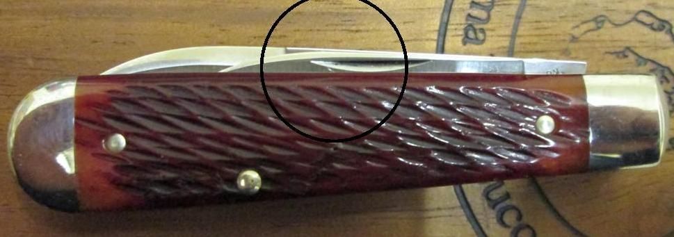

I'm no expert Jake, but take a look at the sketch I did on the previous page. The distance from the backspring pin to the blade tang could be longer and/or, the scallop under the backspring near the pivot hole could be increased to thin the spring down making for a lighter pull.
Notice what Rick Menefee did on the backspring of the knife he built me.
