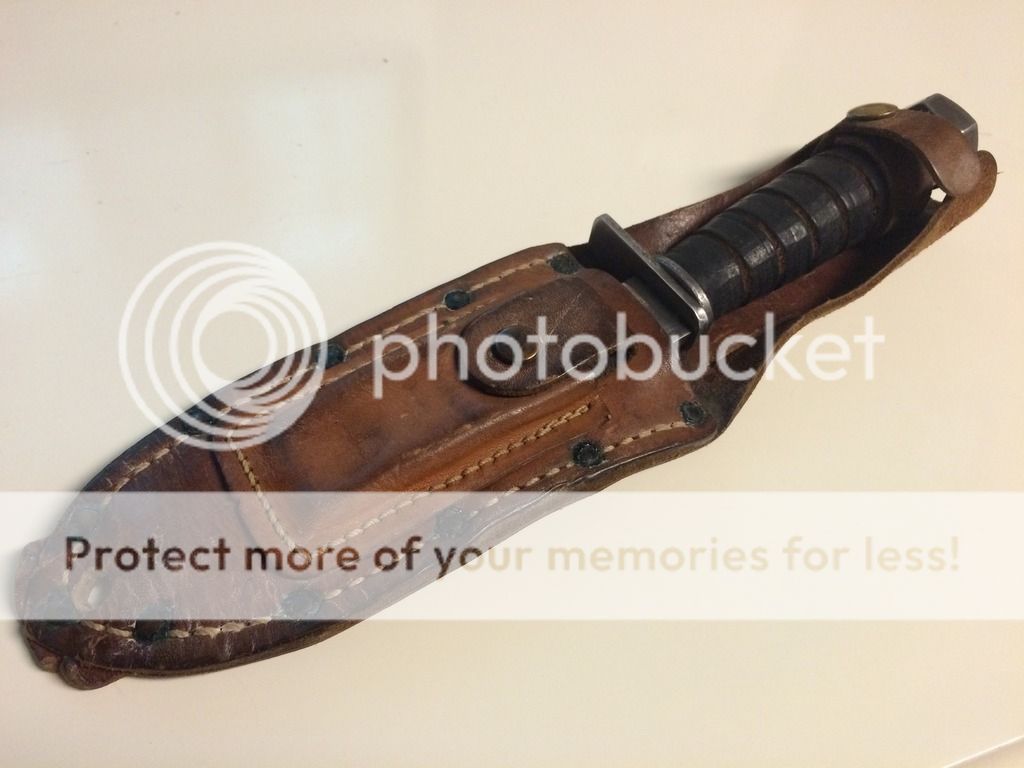

Couple years ago my Dad sent me a box of his old knives.
Among them was his Camillus Pilot's Survival Knife from '67.
This was a knife that I was fascinated by as a kid and whenever we'd go camping I'd be thrilled when my Dad let me wear it. Made me feel like Rambo or something.
When he sent me the box and I saw the knife in there, I was overwhelmed with nostalgia but when I pulled it out of it's sheath, extremely dismayed at the condition of the blade.
Apparently at some point a "friend" of my Dad offered to "sharpen" his knives... on his grinding wheel. Needless to say, the blade was rendered nearly FUBAR.
The tip must have gotten broken off at some point because it's fully rounded off now and the "grinding" job made the swedge grind wrap all the way around to the primary grind. It just looks comical now.
Anyways, the point of this thread is that I've started working to "recondition" the whole knife and am starting to wonder... Am I wasting my time?
I'm probably doing everything wrong but figure I can't really mess it up too much worse than before.
The part I'm interested in is if it's even possible to get one of these admittedly low quality knifes to a somewhat serviceable condition?
It's too late to turn back now since I started polishing, trimmed the guard and overall spent a few hours on it.
I guess I'm at a nexus in that if I decide to continue I can keep working it by myself or look into having someone with more experience and better tools complete the work.
For what it's worth, here's a picture of the knife as I got it (center right):
He also gave me that M7 and the sharpening stone and oil. I'm not even sure if that stone is useable any more...
Thoughts, comments and criticism are welcome.

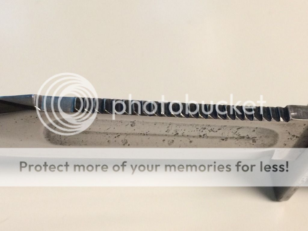

Okay, so it's been a while since I've updated this... Had stuff to do and whatnot.
Re-tipped and polished:
Still need to put an edge on it, which I'll probably do this weekend.

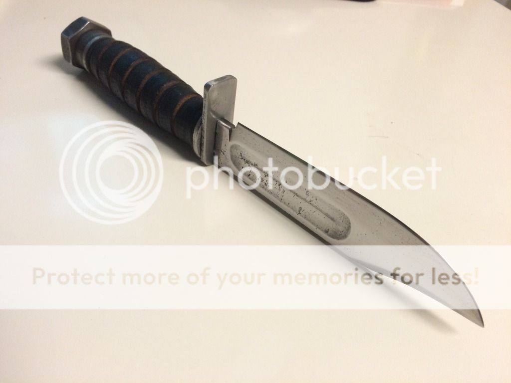

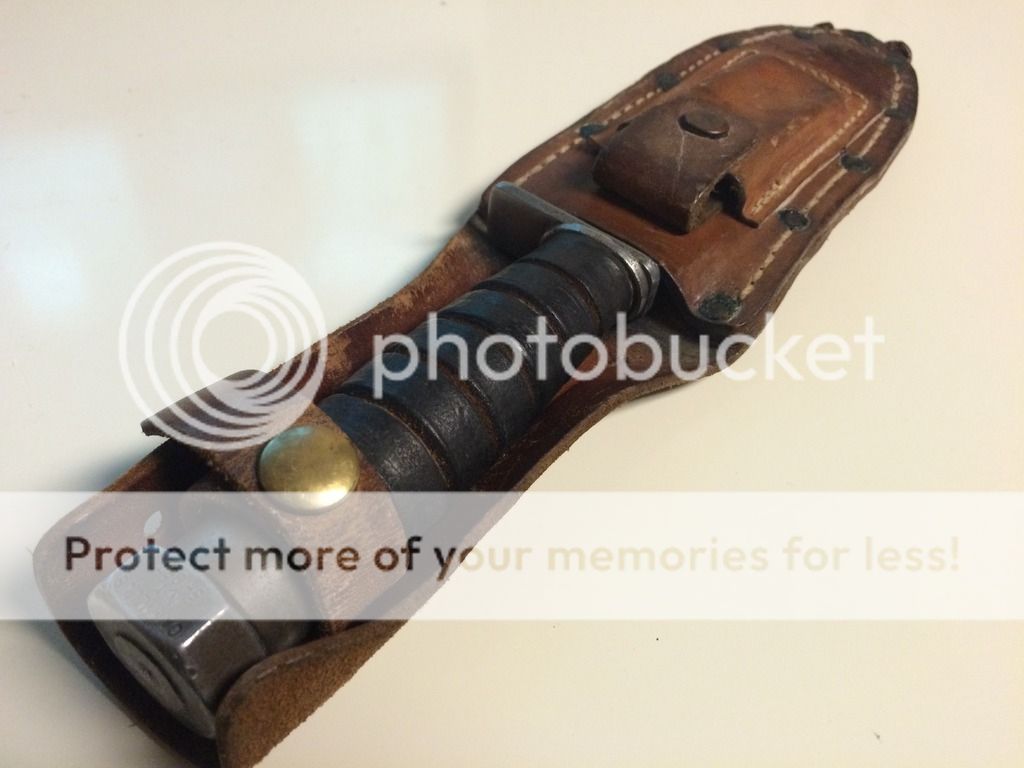

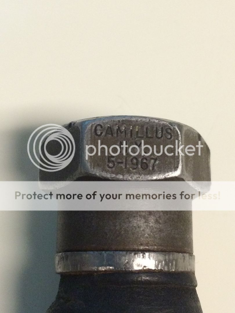

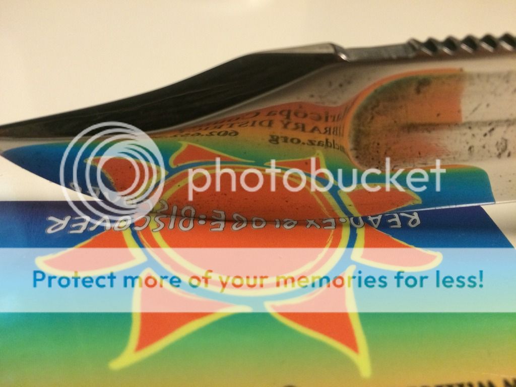

Took me a little longer than I anticipated to finish up the blade but here it is...
To sum up everything I did:
  • Filed down and re-tipped
  • Cut off the top of the guard
  • Altered the "saw" by filing down the edges and removing the last three "teeth" before the swedge
  • Unsharpened the swedge (it had been put to the grinder as well)
  • Cleaned up the grinder marks on the blade
  • Sanded/Polished it from 200 all the way to 2000 grit, including Flitz silicone polish compound and Hoppe's polishing cloth
  • Applied some lanolin to the handle
  • Attempted to convex sharpen the edge with sandpaper and a old mousepad... with mixed results. Finally got a decent edge with just my cheap-o Lansky ceramic rod set up at 20˚/side
  • Forced mustard/vinegar patina
  • Slight polishing of the primary bevel after-the-fact for aesthetics
  • Light coat of mineral oil on all the steel
Only a couple slight cuts to myself in the process!
Overall I'm pretty satisfied with the outcome. The only thing I may continue to work on is the guard is loose but I think oiling up the stacked leather handle with some mink oil might fix that when the gaskets expand.
Keeping the sheath as-is because it's remarkably in good shape for how old it is... 48 years!
