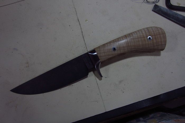

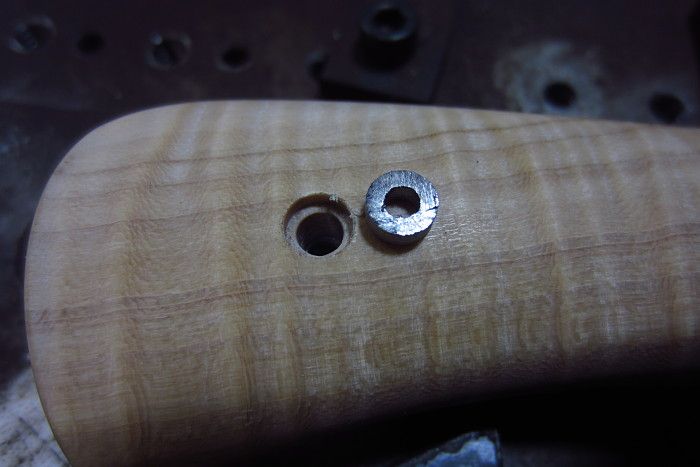

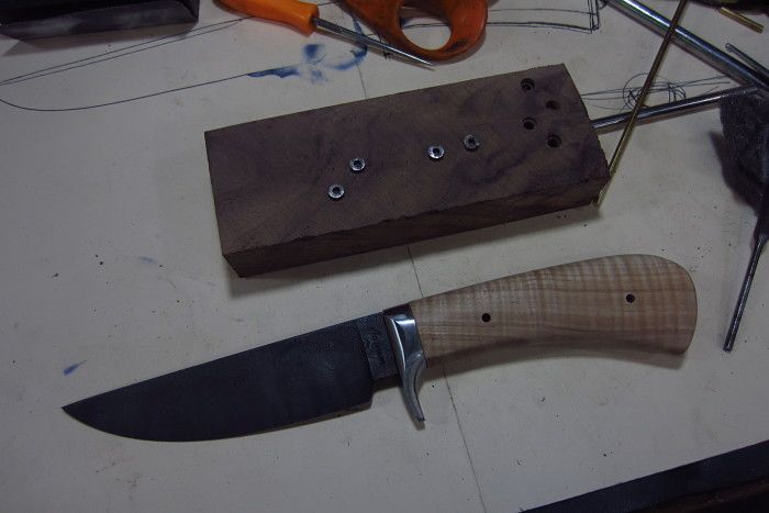

Often, when I pin mortised handles on, I make a pin "socket" to hold the handle and to eliminate all the lateral stress on the handle material.
Drill pin holes:
Counter sink holes for sockets made by drilling 1/8" hole in 1/4" stock:
Epoxy in place:
When you peen the pin, it smooshes laterally into the socket, holding it very tight.
This is how one looks when sanded smooth.
This is how they look when left in the peened condition:

Karl's method is an old one used for centuries. It is called "Cutler's Riveting" in some old books. That is a bit confusing since the two part hammered together rivets currently used on mass produced knives are called Cutlers Rivets ( because they look similar to a real Cutler's Riveted Handle).
The old standard for cutler's riveting was to use a copper washer for the rivet shoulder and a soft iron rivet. The washer was often chamfered to make the rivet fit very tight and give a rock solid handle attachment. In those days there wasn't any epoxy to make the joint stronger. Many 100+ year old knife handles attached this way are still tight as the day they were riveted.

I have a few old knives from my Great Grandfather's saw mill that have the old style cutler rivets. They are very strong, but I think Karl has improved on the idea. The ones I have, are a relatively thin copper washer with a mild steel pin passed through and peened.
Karl's method has what I would call a sleeve or collar... that's a lot beefier. :thumbup: :)
