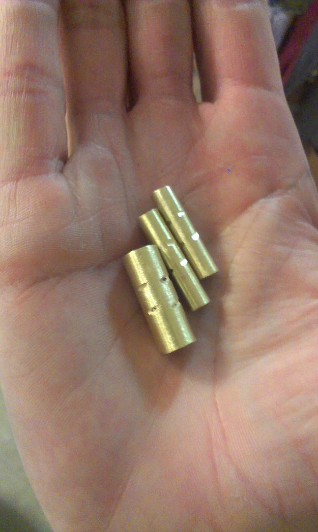

Do you notch the pins where they meet the handle material?

I don't know what you mean by "notch" notch the pins. I don't notch the pins at all. Sand the pin material agressively with 60 grit paper before cutting the stock then chamfer. Like most of the guys here, I use West Marine G-Flex epoxy. I like the long open time and the bond is rediculous. I've had to remove the scales on a few since I started G-Flex. I use a framing chisel to do this. Generally with 30 minute epoxy I could shear the scales off with the big slick. But with Gflex the micarta will delaminate so now I just file 13 the ones I mess up while handle shaping.
Andy, he means like this.
Gives the pins something to grab onto the epoxy with.
Ahhh. Well then no. I do not notch my pins.
Zero clearance, meaning flush with the surface/contour of the handle material?
